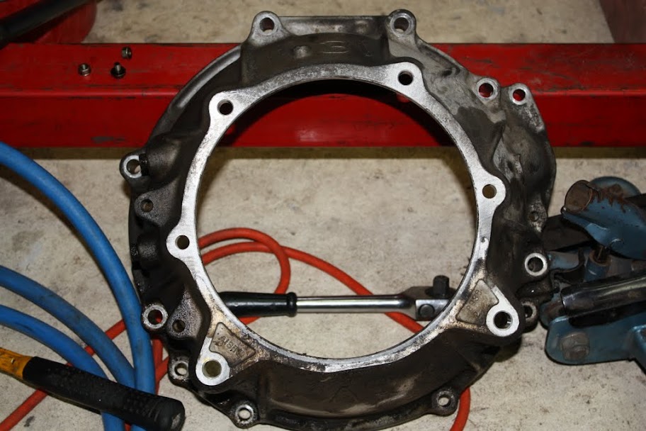

  11. #56
    1,917
    Default Re: Gearbox adapter plate minimum thickness for threaded holes
    One other thing, I dont know if this is standard with the 1uz auto bellhousings that you've made adapters for..
    But the 6x holes that are used to bolt bellhousing to gearbox, are not inline with the holes that bolt the bellhousing to the block.
    Confusing.. so lets say the 2x holes that are used to bolt the bellhousing to the block at the top of the block, and if we use these holes as a starting point to get everything level and straight, the 2 top holes to bolt the gearbox onto bellhousing would be probably 10 deg or so offset..
    Let me get a pic... brb
    1996 FZJ80 Landcruiser.
    Email : [email protected]
  12. #57
    1,917
    So this explains it better.
    Now funny enough if the holes for gearbox to bellhousing are meant to be on a flat horizontal plane with your adapter plate, then your adapter plate very well may not need any change at all.. As the top 2x bolt holes are perfectly horizontal when the bellhousing is bolted to the engine..
  13. #58
    8,214
    That does seem random with the bellhousing rotated like that, as if the 3VZ-E was installed on a tilt.
    Peewee
    2013 86 GTS
  14. #59
    3,275
    That makes a bit of sense, Joel.
    The 5VZ was a RWD config & shares the bellhousing/engine pattern with the 3VZ & 1MZ.
    The engine is canted over in the FWD models so that they fit into the engine bay better. I noticed that the V6s are not tilted as much as the inline 4s.
    Maybe if you can get hold of a Prado bellhousing & it happens to bolt upto the W58 (I'm not sure what box is in the Prado), then it may straighten everything up anyway.
    BTW, I've got access to an A0 scanner at work.
    I've done a tracing of the E151 gearbox face & also a 2GR-FE block, which I'm aiming to get into CAD (scanned in as JPG & then trace over the top).
    If you can get some tracings done, I could possibly do the same for other combos.
    Edit: just noticed that the pic is of the RWD casing...
  15. #60
    New Zealand
    1,879
    Just out of interest, weren't there 2 different UZ bellhousings (U1 and U2) with one being on a slant? I'm sure the adaptor plates sold by Choke on the Smoke Racing in Rotorua NZ ask you to specify which one you have.
