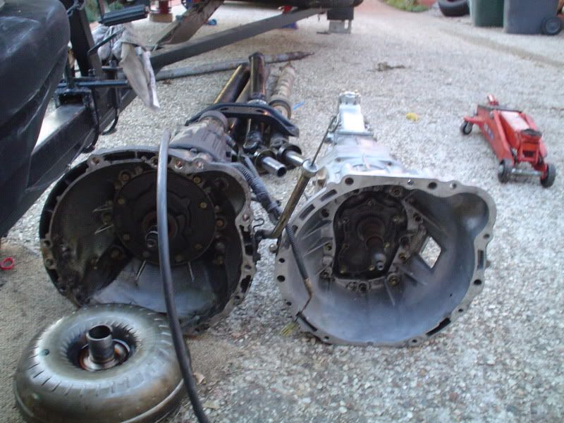

    8,214
    Default Re: RT142 OD auto into mx32 - swap bell?
    These photos are about 5 years old (the other box in the picture is a W50)
    The autobox in the photo is an A43DE from an '86 Cressida (5MGE)

    Junior Member Grease Monkey markiitourerv's Avatar
    south australia
    60
    thanks for the pics, I'll drag mine out tomorrow and check it out.
    certainly looks like the 5mge box has non removable bellhousing, maybe 5me box is different.

    8,214
    Yeah, looks identical to the one in my photo.
    I'd class that as a non-removable bellhousing, as I'm pretty sure there is a lot of gear held in that bit that unbolts.
    However, I'm happy to stand corrected as I never removed the TC and looked.

    3,468
    Pretty sure the bellhousing can be removed without taking the oil pump off the front of the auto. (I've done it).
    See below pic. MX62 A43D on left.
