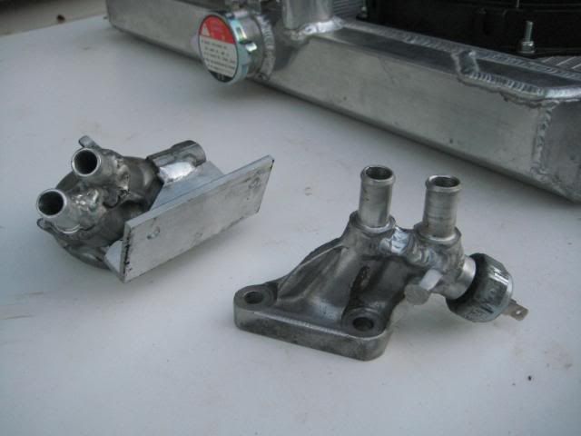

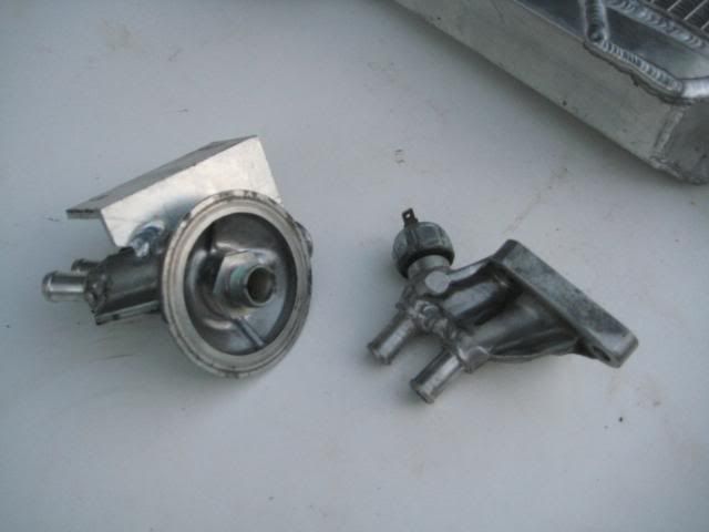

    Here's what I just knocked up for mine.
    Not bad actually. The hoses are a little long, and the pipes still are too, but it didnt' cost me a thing and it's functional!

    Default Re: 1UZ oil filter mounting options
    ^^^ 100psi of oil pressure and worm drive clamps? not a good idea mate
    2,121
    That did cross my mind. So I was plannign to test it.
    That said, I've spoken to the guys at HIS Hose, and they have suggested it might be ok, given how hard it was to get the hose on (and subsequently can't get it off again.)
    It might act like the push on barbed fittings do
    We'll see though, if not, it's off to get barbed fittings.
    Facebook | LinkedIn
    If not you run the risk of engine bay oil fire, spinning into a tree etc
    2,121
    yeah, you have a good point.
    I will be testing it at Idle in the next few days, and see if it's got the slightest leak
    I will then probably have my concience get the better of me and I'll go get the barbed pressure appropriate fittings for it.
    Seeing as the whole reason I need the stupid thing was to avoid a different oil fire in the first place!!!
    Facebook | LinkedIn
    4,152
    At the very least, I'd be concerned about using them without a ridge or hump for them clamp against. As is, there is nothing to stop them bar their tension against where the clamp is itself.
    2,121
    Other than the fact that I can't pull them off for love nor money. :-)
    I think I'll get a lip rolled onto them so the hose clamp has something to clamp against.
    Facebook | LinkedIn
