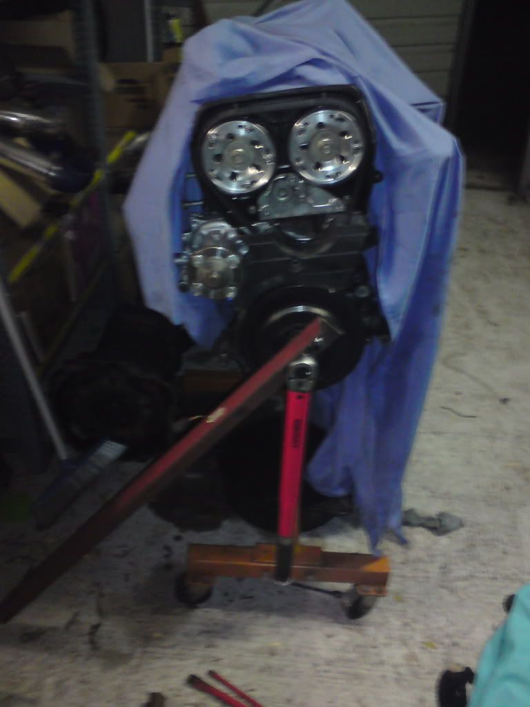

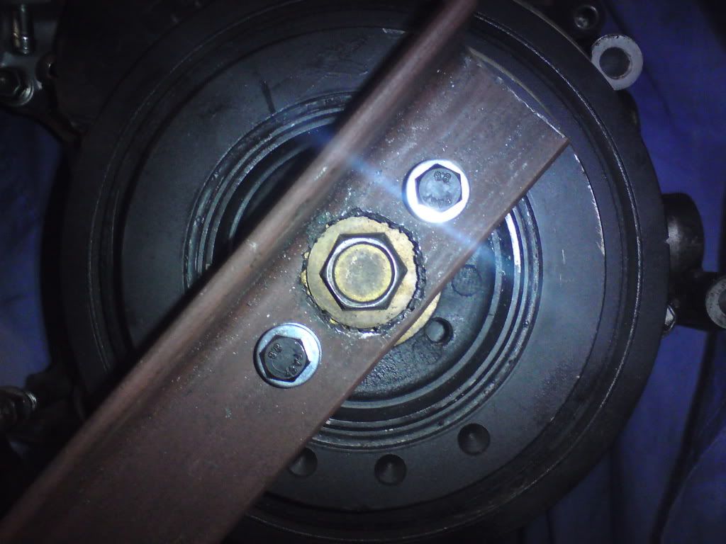

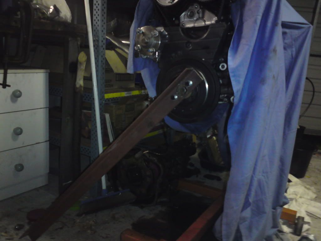

    knocked this up last weekend
    pretty much the same as requiem's only 40x40x5 angle

    Engines looking good beatle. Wish I had more time to finish mine.
