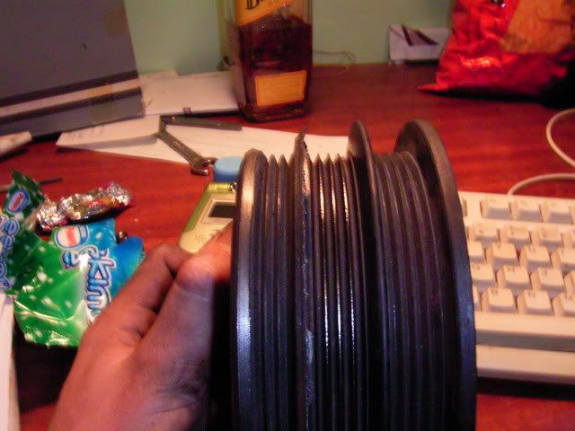

    can i tack another question on?
    well i will, tell me to get rif of it if you dont want it. but what happens if your harmonic balancer is ground down like this...
    that back "Wall" closest to my hand, should be same size as the front one. has now been replaced but wondering what damage i may have done?

    For starters all motors have some sort of balancer at the front of the engine not just 6s/8s.
    Loveke70:
    Grindng down the balancer will have no effect on how the engine performs as long as the balancer is balanced after modification(could cause vibration otherwise). I have actually machined the front half of mine off so that I am just left with the one pulley to run the alternator and waterpump (I had my balancer re-balanced).

    Loveke70: As I had already discussed with you, if the thing is out of balance, it will damage your crank. Do you not listen to anything I tell you?
    1jzracing: The underdrive pulleys from the US or whereever else, are still harmonic balancers. Atleast they should be if they are a replacement for your present harmonic balancer. They will still have an effect on the harmonic balance of the crank, but they will also have a smaller diameter(Or larger if that's what your after) that will drive your ancillaries at a different rate.
