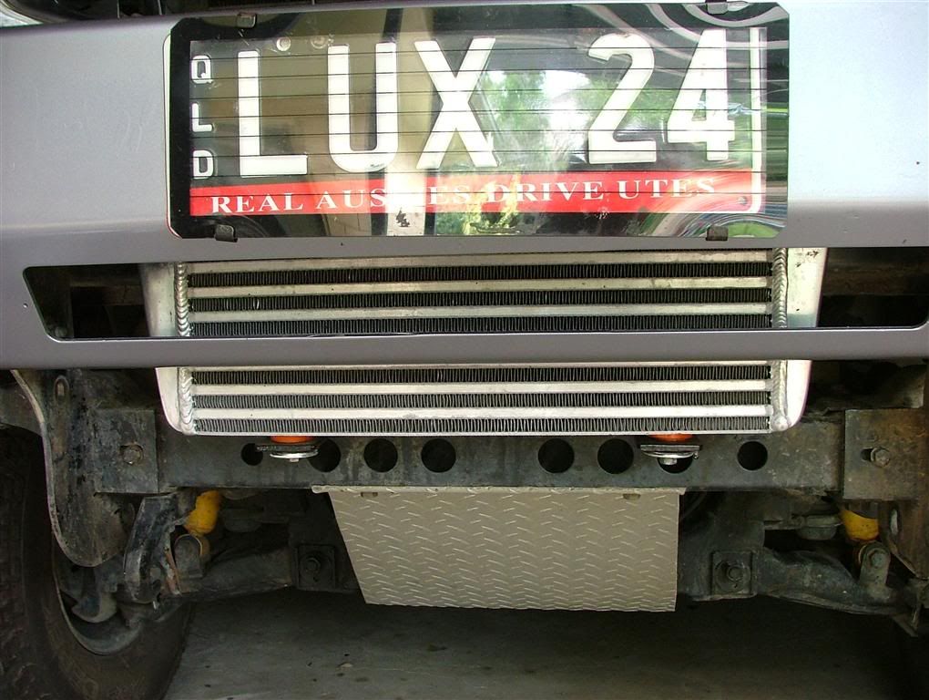

    Just an update on the Supercharged Lux.... the TRD Supercharger has gone to a new home and we've put a restrictor in the Exhaust System
    Only giveaway from the outside is this....But when making visual contact with the smile on the drivers face...you know something's going on

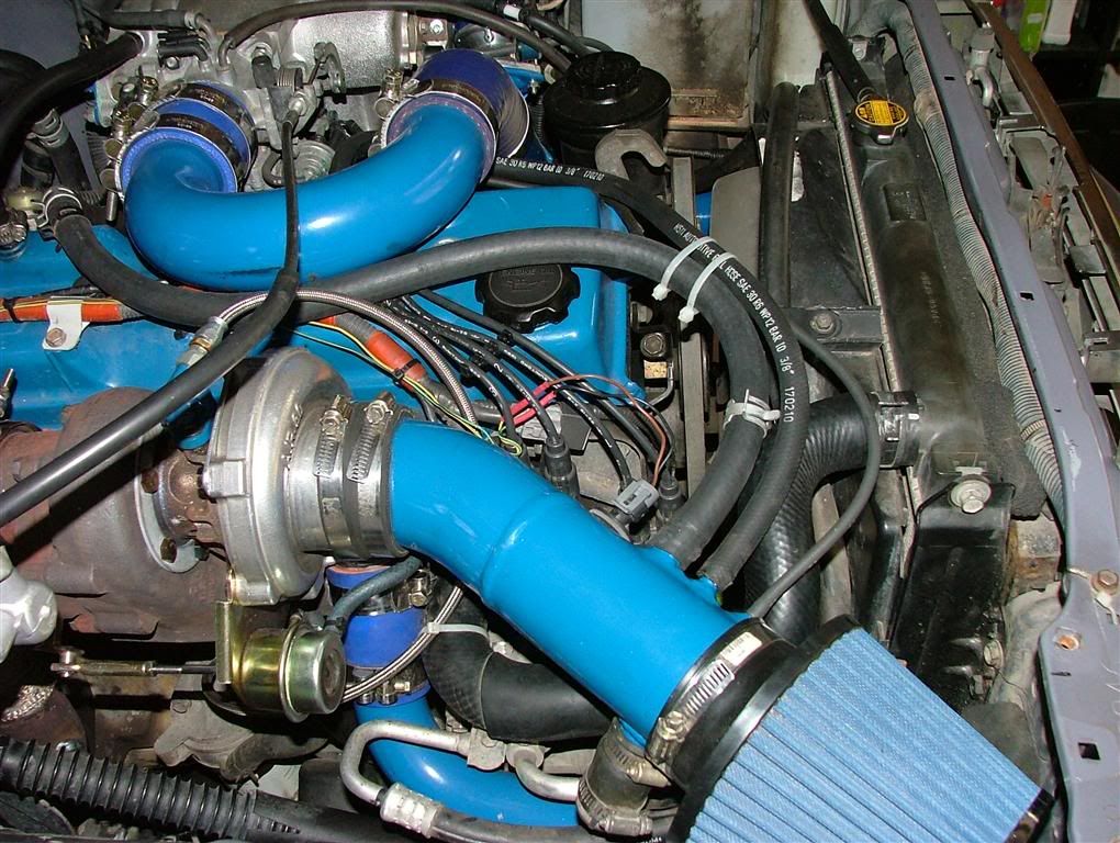

    Still fiddling with things, but at present 150kw at the wheels (11psi). ( The best from the Supercharger was 118kw) That's about all we want as we want to keep it as reliable as possible.
    Have not driven much yet as we still have to get some heat shielding in place, and the guy who tuned it is not completely satisfied with the RX7 injectors we put in because they only discharge from one spot where the originals are from 2 to feed the dual port head.
    Only other issues are it's a bit of a pig till it warms up to normal operating temps. After that it's fine. Pulls really well from low revs to redline with no noticeable flat spots.
    Really happy with it considering it's a fairly mild setup done on a tight budget.
    The Engine has done 270,000km and hasn't been touched apart from the tappet cover taken off to paint that four letter word (Ford) blue
    Some Details;
    Chinese Ceramic Ball Bearing T3/T4 Internal gate Turbo
    Chinese Intercooler
    Greddy Copy BOV
    Home Made Log Manifold
    2.5 inch Exhaust
    Haltech Sprint 500
    RX7 Injectors
    Pod Filter
    Standard Fuel Pump
    Standard everything else.
