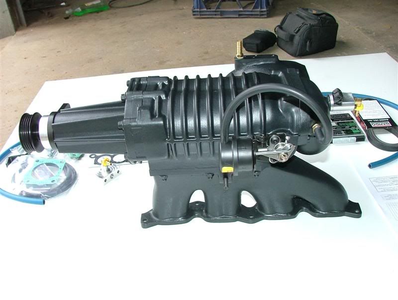

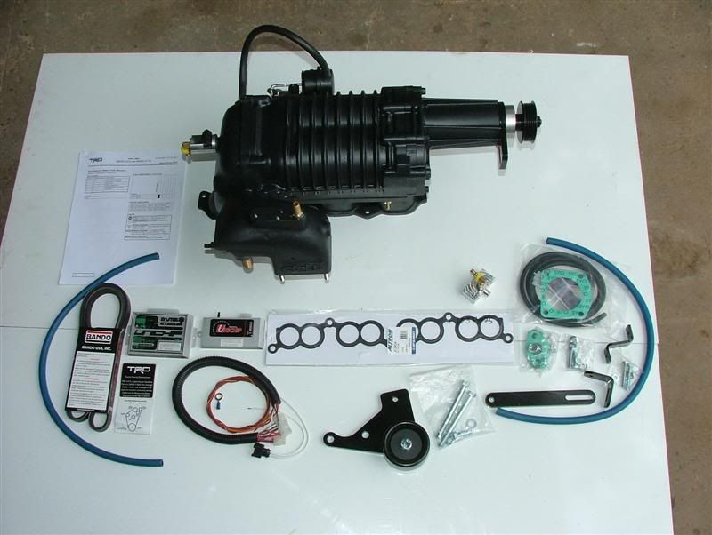

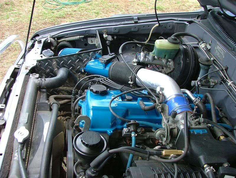

    Well...It arrived today 8 days after leaving LC Engineering's Workshop.
    3 days to travel half way around the world.....and 5 days from Sydney to my place(just north of Brisvegas)
    Patience not being a strong point...we had to get into it straight away.
    Fast forward about 4 hours (includes smoko break of course!)
    A couple more pics
    Enough for today.... Still got to connect the 5th Injector and wire in the Piggy back gear.
    P.S. We did give it a short run on the original ECU and without the 5th Injector and there is a significant improvement in performance.

    A few weeks later.....

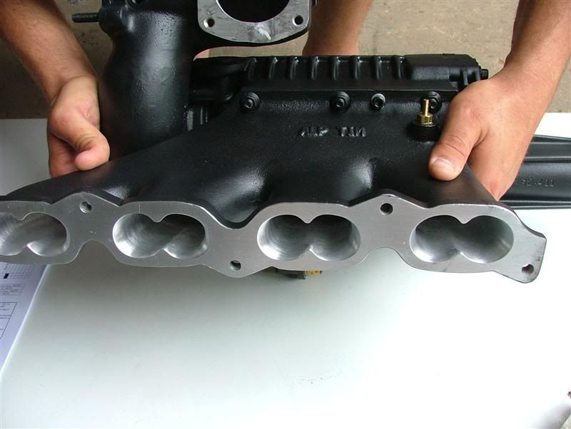

    Seems like the so called expert advice on the Unichip is pretty much Bulls**t. Have had it tuned by another Unichip Agent, and have had some success. Problem now is the restricted inlet and exhaust.
    A bit later......
    Have fitted a two & half inch exhaust from the y piece on the manifold straight thru now with no exhaust restrictions.
    Modified the intake as per photo below and have now booked for a tune and dyno for the
    18th January when the guy starts work again after his Chrissy break.
    It is already going heaps better, but am reluctant to give it too much before the Unichip retune.
