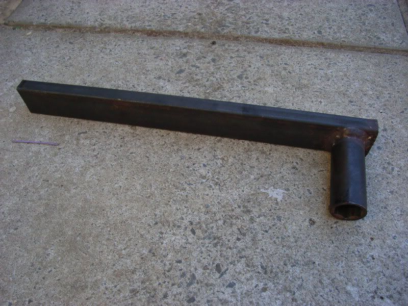

ive had some tough ones too , so i made this tool up .. never failed as yet .. YOU WONT BREAK THE TOOL or bend it so go hard !!!
it started out as a 1metre long bar but i found it to be more effective at this length just put it in upright postion and crank the starter .. it just clears the battery and smashes on the ground , cracking the bolt.
if its a really tough one , just place it so it has more swing.
dodgey but effective !

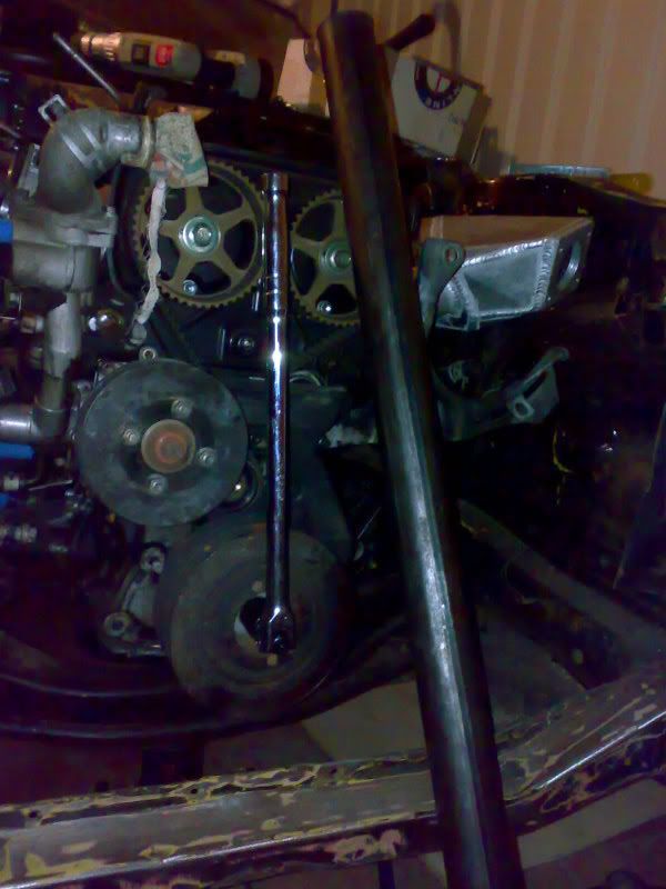

Pulled engine and box out, then seperated box and removed clutch. Chained flywheel up, and got the big hurter with old 1/2" socket and 22mm impact socket onto the job - brokeded it, swore!
Next was a Powerbar as shown above - brokeded it too, other people swore:
Final straw - I hired a Mongo (6'+ 100Kg mate with a Repco 1/2" breaker bar and a desire to kill it!), added the big hurter to the breaker bar, and strained like fuck - brokeded it - the bolt from it's bastard hold on the crank thread that is! Pulled the bolt out, doesn't show any signs of "loctite or similar" adhesive, but does show corrosion on the end. I can now progress with the timing belt change! FWIW, I expected the Repco bar to break too, but upon closer inspection, the drive peice is black/hardened steel, so I'll happily add one of these items to my toolkit - and recommend one to everyone else too.
