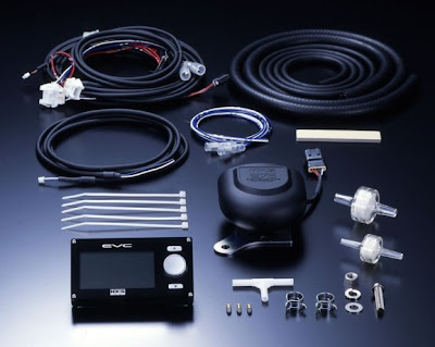

    the greddy map sensors usually come with a filter that should smooth out the reading. The filter looks just like the two clear plastic filters in this pic: http://2.bp.blogspot.com/_vBqLJNBqOX...oller+evc6.jpg

    fwiw: a mig welding nozzle (edit: contact tip) anywhere from 0.6 to 0.8 stuffed into the flexible line anywhere before the map sensor will also 'filter' a noisy signal.
  4. #379
    3,235
    Default Re: The Tuning Talk Thread - Forced Induction EFI & JZ Tuning.
    Never thought of that one chuckster, good idea. I've used small 6mm fuel filters before also, after a local tuner put me onto the idea. At least your method will never fail, unlike a plastic filter which I assume will eventually fatigue from cycling between pressure and vacuum all of the time.
    You mean "contact tips" though right? Might be a bit hard to fit the nozzle into a hose line

    Mecahnical smoothing Vs Electronic filters in the ECU's?
    Is that distortion in the MAP signal actually noise? or does it represent what is acutally going on and therfore should be used as is?
  6. #381
    3,235
    Usually represents what is actually happening in the manifold, and so can be useful, but without any form of signal conditioning can be a PITA with parameters like boost cut, if the fluctuations either side of average are particularly wild.
  7. #382
    1JZ-Rolla: oops, contact tip is the right term.
    OnAll-FOUR: the restriction helps reduce (tho not eliminate) the pulsing you'll get from: massive throttle changes (often at slow air speeds), pulsing from short runners (e.g. ITBs) and aggressive cams (especially at low revs). Is also helpful when you have an ECU that doesn't do any 'smoothing' of engine state sensor input.
    Example: engine at low revs and minimal load, throttle is suddenly pushed to 100%, ECU will pickup on the TPS change and enrich based on acceleration settings, MAP will briefly fluctuate until the plenum stabilises to the new vacuum state but will continue to be affected by pulses travelling up/down runners leading to each valve. End result is an engine under load with minimal changes in RPM until the accel enrichment does it's thing, low and variable MAP contributing to highly variable inj pulse-widths and possibly also timing. At higher engine revs, the faster air speed into the plenum and higher frequency of runner pulses has far less effect on MAP noise.
    Engines with ITBs on short runners suffer from noisy MAP signals - especially if only one port is used for MAP reference. Hence the use of ports on each throttle and some kind of balancing chamber to combine the 'signals'.
    Remember that this tricks helps most when where you have quite short injector pulse widths. At idle, minor changes in PW will have a fairly dramatic effect on the amount of fuel delivered (e.g. at idle, INJ open time might be 2 m/s, variations of 0.1 to 0.2 m/s will deliver 5-10% more fuel, at larger opening times, the same variation is negligible in comparison).
