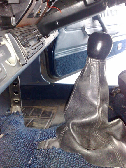

    Thanks chris, i've seen the second set of holes for the cross member, I think that the ra40 ws offered in usa and canada with a 22r in there explaining the second fitment for the later model w5x. How near is the shifter to the dash in fifth etc? I'm not worried about the tunnel, if the shifter position doesnt fit then it wont take much to make it.

    hmm good question. I have sat in it a shifted through the gears with no obvious problem. However, i think the previous owner has shortened this shifter. Not a proper short shifter with a moved pivot point but just cut it off. That might help my clearance with the dash.
    I can try to get a photo showing the angle and the clearance of the shifter in fifth if you like

    yeah, that would be good. I cant trial fit it because the car is my daily driver.

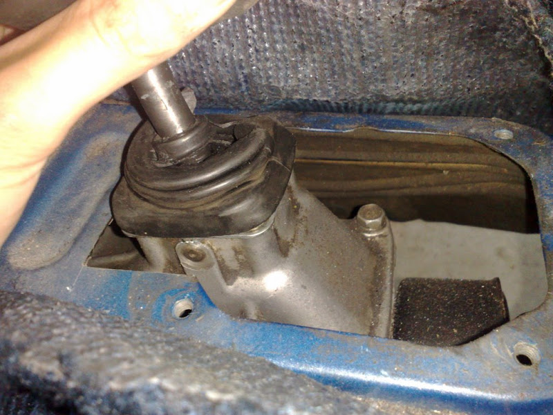

    as requested...

    Looking at both pictures i'm thinking that the factory hole for the shifter is in a different position on the manual 40's and the auto one's.

    quite possible i guess. when i get home I'll get a side on picture of my w50 extension housing. This might give you a better indication.

    You've used an RA60/5 shifter positioner on that.
    Remove it and replace it with an M/GA70 shifter positioner and she'll come up through the hole.

    Quote Originally Posted by maurice c
    This is the case with most Toyota's at least during the 80's.
    From memory the rear of the hole is usually in the same position, but the front is larger in the manuals.
    Does changing the shifter position require removing the extension housing to change that select arm thing??

    In a nutshell, yes.
    Technically it doesn't need to be completely removed, but it does need to be unbolted and shifted back about 6"
