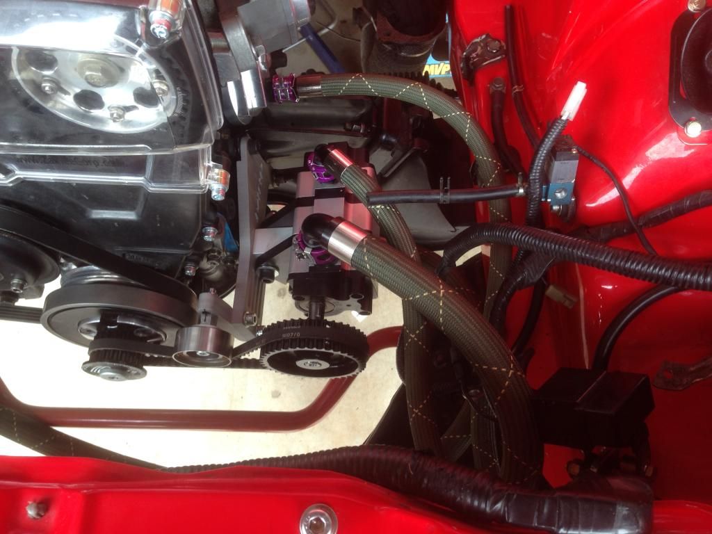

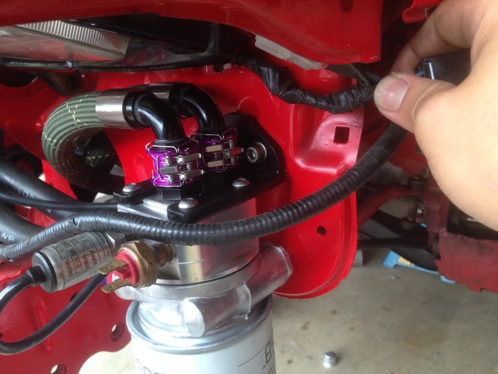

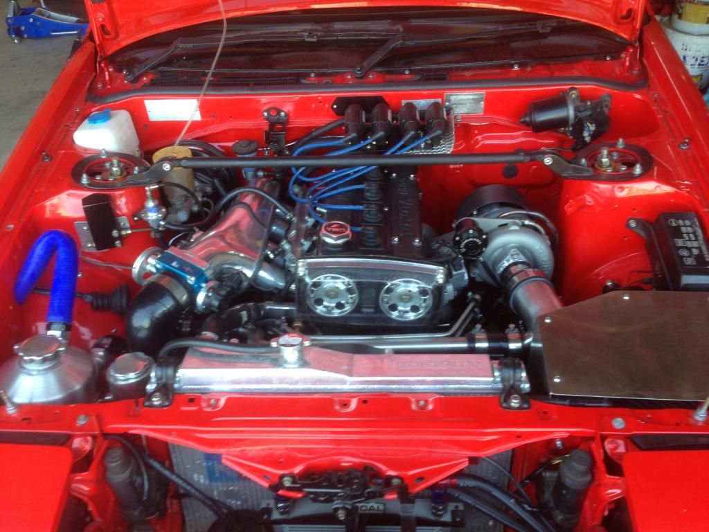

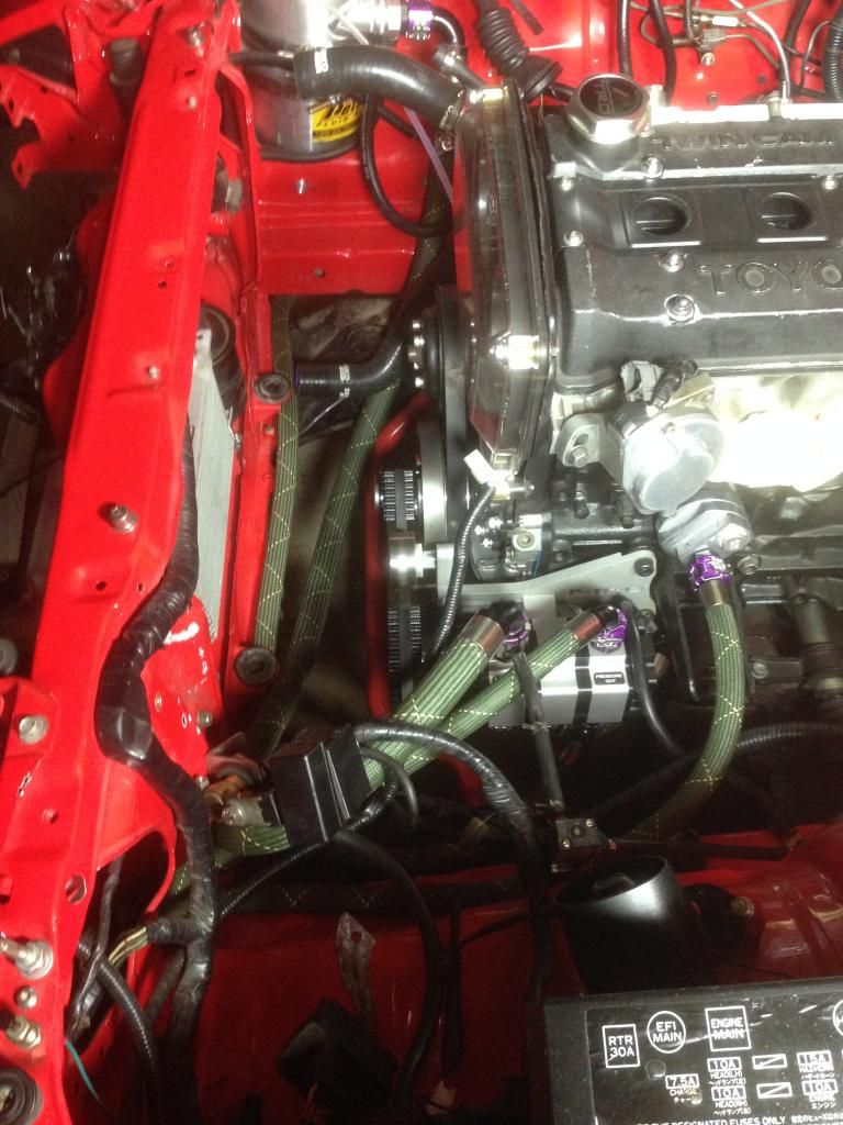

    Toymods Club Member Backyard Mechanic Big T's Avatar
    231
    Default Re: 4age oil pump mods
    Dry sump it. The motor is costing you 12k+ I'm guessing. Insure the thing by dry sumping it. Mrps kit is nice. I have one on my 4agte. Goes on the exhaust side down low. I've even managed to mount the tank in the bay so no lines go into cabin.
    Back together. I do have a proper breather hose now instead of the blue radiator hose!
    4agte finally completed. 234rwkw @ 8125rpm. Tis fun
