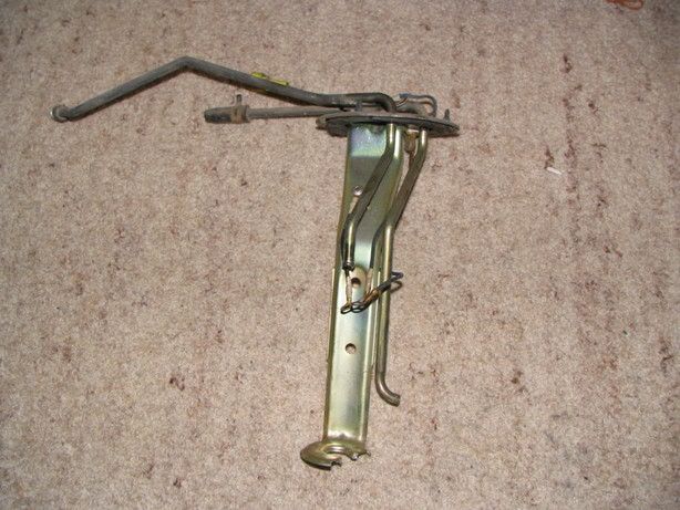

    Would this be what you're after? If Toyota proves too expensive, give us a holler.

    yep that is the part! the threaded bolt in the pic sheared straight off, talk about castrating the supra so it can't go anywhere!

    the threaded bit on the end of that longer pipe on the external side?
    if thats it, i wouldve cut the fittings off, on both sides (car and pump bracket) and hose clamped a section of high pressure EFI tubing on there...

    was going to do exactly as you suggested at least to get me out of trouble.
    but i don't want to add another weak link to the system, possibly if the metal fuel lines had flared ends (to get a better seal, like a radiator pipe on the radiator outlet). I actually did this with the nut end but found flaring the bracket end too difficult due to it's shape (would of ended up wrecking the metal pipe).
    No worries yians bracket will be here tommorow and i'll be on the road again.
