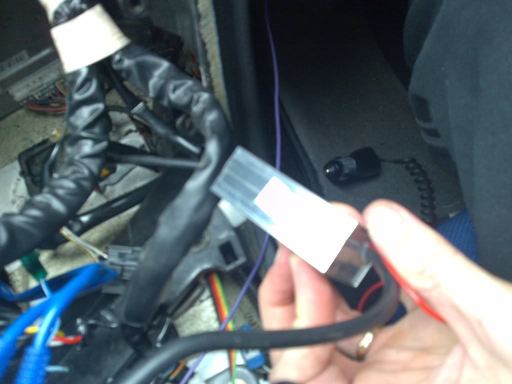

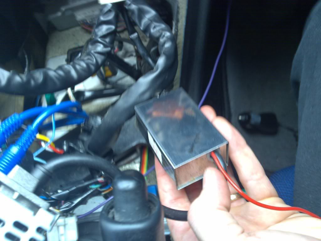

    a little off topic but is this the thing that makes an jap stereo be able to receive aus radio stations?

    1,147
    Default Re: JZA80 electrical issue
    Looks like it, but mine was quite abit smaller, should be inline with your antenna though and then into the HU, it should have power too.
    Junior Member Domestic Engineer 1jz68u's Avatar
    753
    so it should have power?? interesting, it was earthed. strange.
    i did disconnect it from the earth though today so i might connect it to power tomorrow
