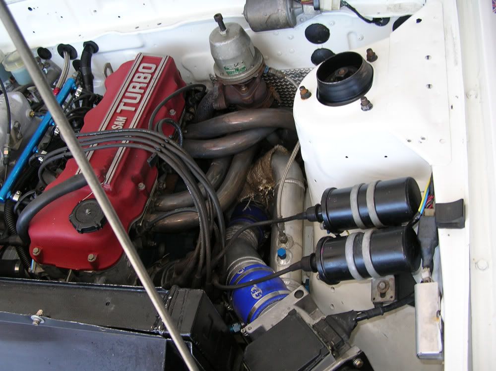

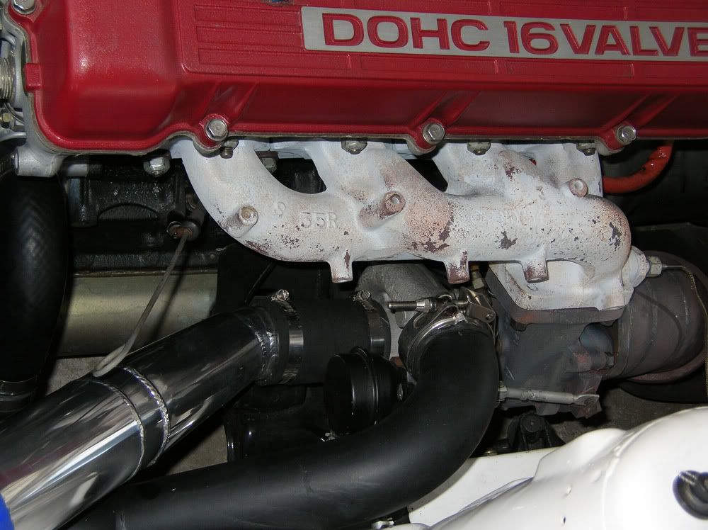

    the sierras were run under group A rules, so turbo location is the stock location
  7. #52
    7,493
    Default Re: 3SGTE manifolds, TRD GT supra.. now with INSIDE PLENUM pics
    Z18ET Group A manifold
    FJ20DET Group A Manifold
