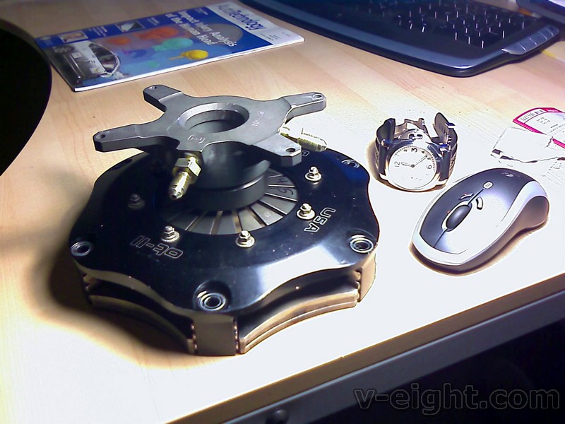

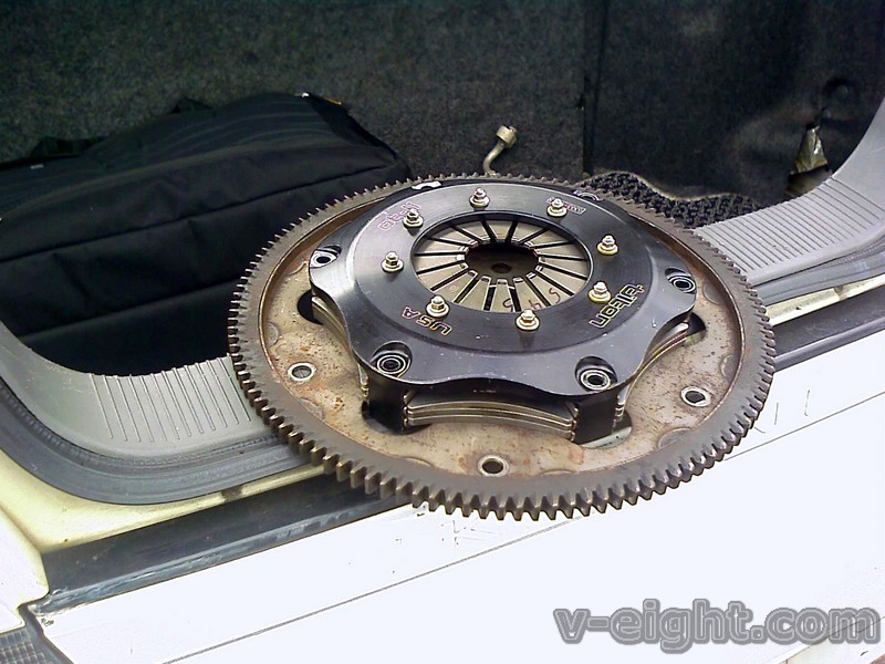

    you need one of these puppies

    I believe you are going soft and removing one of the plates - is that correct?
