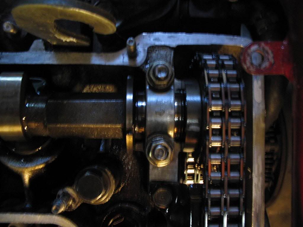

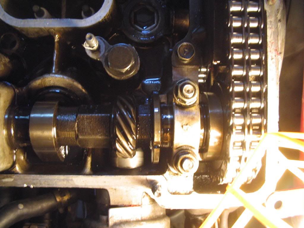

    What is the compression like in each cylinder dry and wet?
    Did you set the cams up so that the cut-outs face up and the cam lobes face away from each other when cylinder 1 is at top dead center on the compression stroke?
    Hope you didn't bend any valves in the process.

    Damn also hope I didnt bent valves
  11. #1136
    711
    Default Re: 3T GTE Tech
    just an example, this is enough to bend 6 valves.
