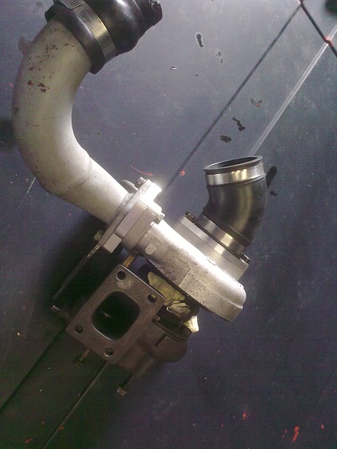

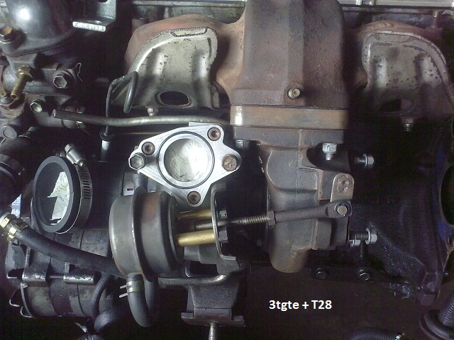

    t28 conversion (chinese t28, but measures same as t25 compressor haha).
    Did this as was offered turbo dirt cheap. made conversion so can swap to genuine s14/s15 later. or back to ct20 if i had to.
    oem 3tgte manifold w/ custom cnc adapter plate. 16mm thick, counter bored for cap screws.
    Modified 12psi t3 wastegate actuator to suit re-clock of housings.
    Custom 1/4" double flared oil feed line and 7/16"-24 reverse flare nut (brake fitting). tight space for oil feed due to turbine flange proximity.
    Turbo core sits further rearward than ct20 which can cause oil drain clearance issues.
    Modified 3tgt oil drain- cut/offset 40mm and lengthened near the block + drill out oil feed from flange and trim the end. had to section engine mount for clearance better option would be to make drain flange and custom angle on drain pipe?
    Shortened/bent s14 water cooling pipes (banjo fittings on turbo). barb added to engine end.

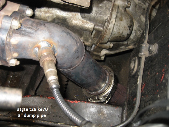

    Custom 3" dump pipe. In car pic. I tried S14 and R31 std dumpy but they hit ke70 chassis rail. Easy option is buy aftermarket sr20det dump and section/weld to correct the angle.
    Custom compressor inlet and outlet adapters to fit oem 3tgt piping. could possibly use oem s14/s15 parts here?
    China turbo died on first drive. unbalanced from manufacturer.
    so bought pr r32/33 skyline gtr rb26dett t28's
    Custom made 2bolt compressor outlet adapter plate to suit ct20 2bolt piping. (a 2L-T ct20 50mm outlet is easily mod'd to suit).
    Machined china t28 .64A/R turbine housing to suit gtr t28 turbine wheel. (more tip clearance and bigger radius).
    Cant use gtr turbine housing due to stud mounted. and it's puny- 0.48A/R, 2/3 inlet port size and 18mm wastegate. can't swap on a BB turbine housing. but early s14 turbine housing might work with these.
