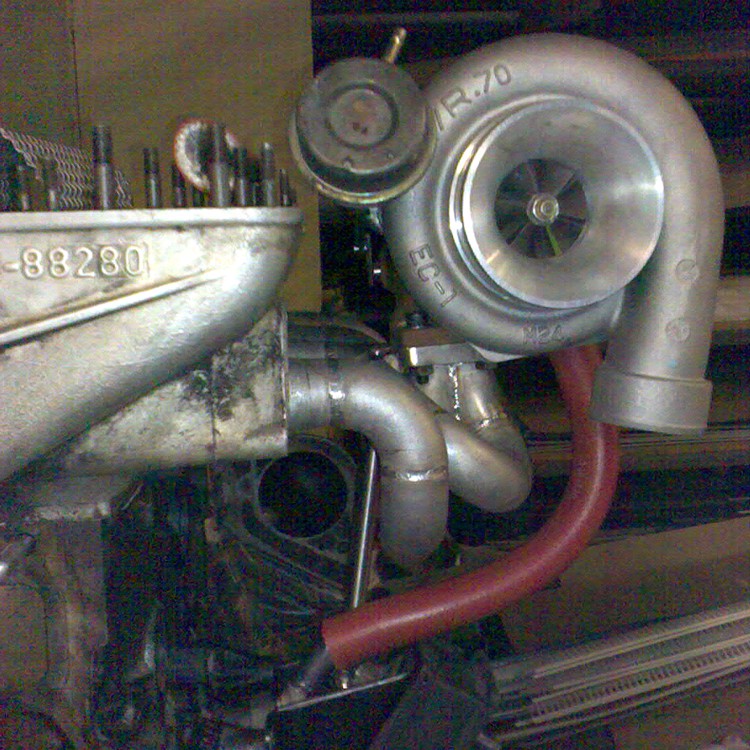

    Looking to get started on the celica today and thought I would check how the actuator mounted to the turbo...WAY TO HIGH! FFS I bought the turbo and manifold to just bolt up, now it looks like the bracket will have to be made to hold the actuator, and I still think we will have bonnet clearance issues which means the manifold itself may have to be redone! FFS!

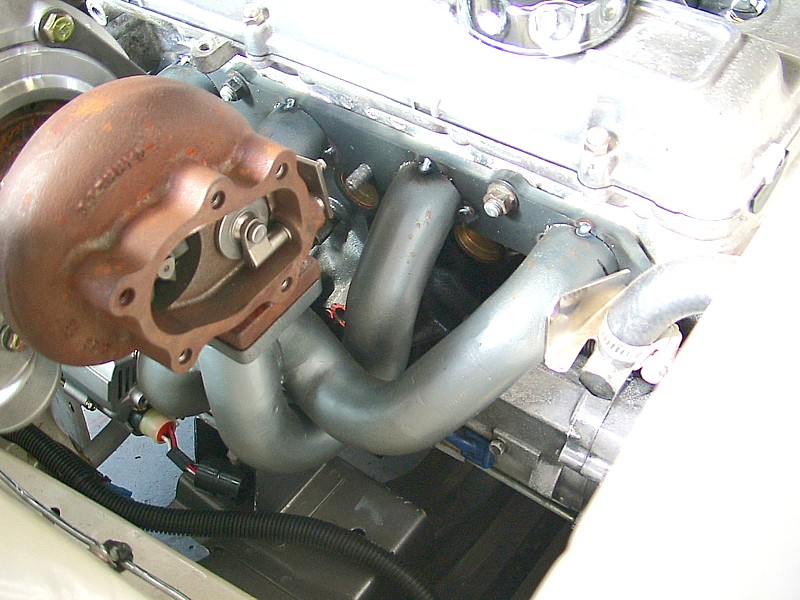

    Quote Originally Posted by RiceburnaGTV View Post
    Anyone got any pics of hi mount turbo set ups on 3tg's?
    Not 3TG but you know the manifold stuff is the same...
    Jason

    Yeah thats the way my outlet want to sit also. Where is your actuator? SHould I just start looking at an externally gated Turbo? I will get some pics up soon..

  12. #1047
    752
    Default Re: 3T GTE Tech
    Hey Ricey can your turbo housings be 'clocked' to suit the direction you need the outlet to sit?
    When you clock the housing you'll most likely need to modify the actuator mount anyhow... So you may as well take the opportunity to have it sit where you need it!
    Jason

    Yeah both the rear of the housing and front can be moved. Actuator will have to be moved but it seriously may just be easier making the exhaust manifold 40mm shorter. Going to look freeking ugly with the actuator right at the top of the turbo tho. Fuck me...

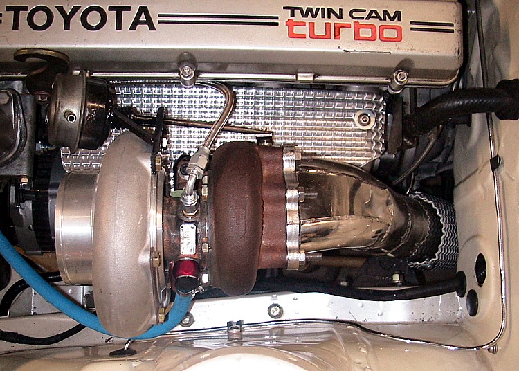

    Hey Ricey,
    Do these help ?
    Same Turbo, Different manifold
