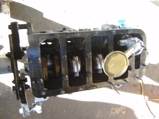

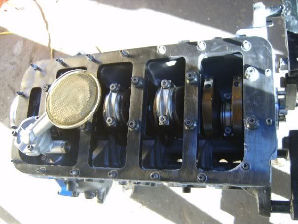

    hi guys i will show here some Custom tricks to strengthen the bottom end of any 2T, 3T or 4T engine!
    A MAIN GRIDDLE
    If you own a push rod head you can do the same for the head to prevent this to crack under hi boost!
    By the way this engine is a Drag engine and produce well over 700WHP and is a stock crankshaft with 87mm Wiseco Pistons!

    That girdle is awsome. Was it a one off or is someone producing them for T - series engines these days? I can't quite tell on my crappy monitor but are the main caps custom or is there spacers/packers under the girdle?
    Glen

    The main Caps and griddle are made by www.PRO-GRAM.com
    and can be purchased at www.Paradiseracing.com just ask for Luis and tell him Toyota1515 sent you there!
    And the Head griddle, is custom made one off!
