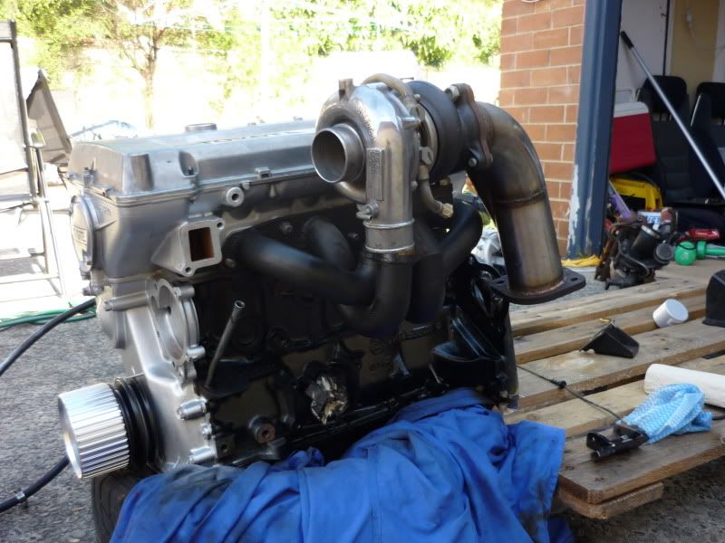

    Hey guys, is it possible to machine off one of the ribs on the harmonic balancer? I know some people who have done it with 1g's but unsure if it can apply to our engines? I need to make some clearance for the gilmer drive pulley and every cm is going to count.

    Why not use a 2tc balancer it fits perfectlly and only comes with one groove for a belt or even better get a BRD aluminum one they are cheap.

    Why do you need to keep any of the V bands if your running the Gilmer belt ?
    And if you space it out that far how are you lining it up on your water pump and alternator ? It will be sitting way out front.

    I think you will find the point is he wants to keep the Harmonic Balancer. So he can ONLY use a 3T-GTE one.

    Hey mate I was under the impression that I had to keep this balancer on if a car came out with one standard? What are the downfalls of taking it off and just putting the pulley on in its place?
    With the current set up I was going to get a 25mm spacer milled up to go over the the existing WP and the alternator can be moved forward pretty easily from first inspection so that doesnt look too bad. All up its pushing the whole lot 25mm more toward the radiator than the furthest point on the old WP. So if I make a 30mm crossflow rad it should just squeeze in.The other problem is that the crank pulley is originally for a small block chev so I need something to bolt it to to make work as it has nothing to center it.
    If I can just wack a pulley on instead of the retaining the existing HB then I will just get the place in NZ that makes them to do me one up from from scratch, they are only $500 nz which is about 40 bucks these days
