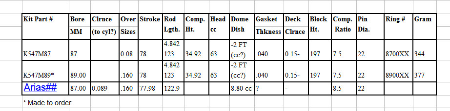

    I have been trying to get a little research done before I order parts.
    First thing is pistons and compression ratio. I have tried to compile all of the CR related info in one spot. (See the link at the bottom for a collection of these posts.)
    The main meat of the info is as follows:
    If any of these require correction, please respond and I will update this post.
    Chamber volume (stock) :
    3T-GTE: 64 cc (my measurement)
    3T-GTE: 60 cc (Yellorolla)
    “3TG”: 65 cc (Turbotoy) (note: “head was milled a couple of times”)
    3T-C: 63 cc (wiseco- PDF)
    Stock 3T-GTE piston dome:
    6 cc (from memory) (YelloRolla)
    7.6 cc (my measurement)
    3T-GTE Comp. height: ???HELP
    (I’m assuming that Compression Height is the same as the pin height – please confirm)
    Rod Length: (From Radar – here)
    2TC, 3TC, 3TG: 4.850
    Stroke: (From Radar – here)
    2TC: 2.75
    3TC, 3TG: 3.070
    Wiseco 3TC (with 63 cc head) (from PDF)
    (Arias 'link' in illustration above is actually to a post in this thread)
    EDIT: Clearance stated in table above for Arias pistons is NOT correct for pistons made from 2618 material, according to Arias tech support (by phone 2011/03/22).
    FT stands for "Flat Top", and -2 is due to the cutouts for the valves.
    I have copied the CR/piston related posts from this thread into one big page.
    I added a few additional questions. The formatting is rubbish, but it ought to be better than digging through this 30 page thread.
    I will add replies and clarifications as necessary.
    Please fill in the blanks where you can!
    http://www.3sgte.com/Carina/3TGTECRweb.htm
    (post back any answers to this thread)

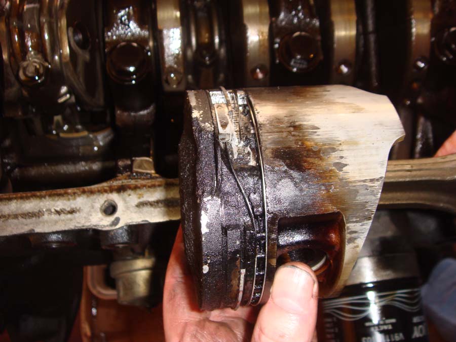

    Today I have a carnage photo and a question.
    Carnage:

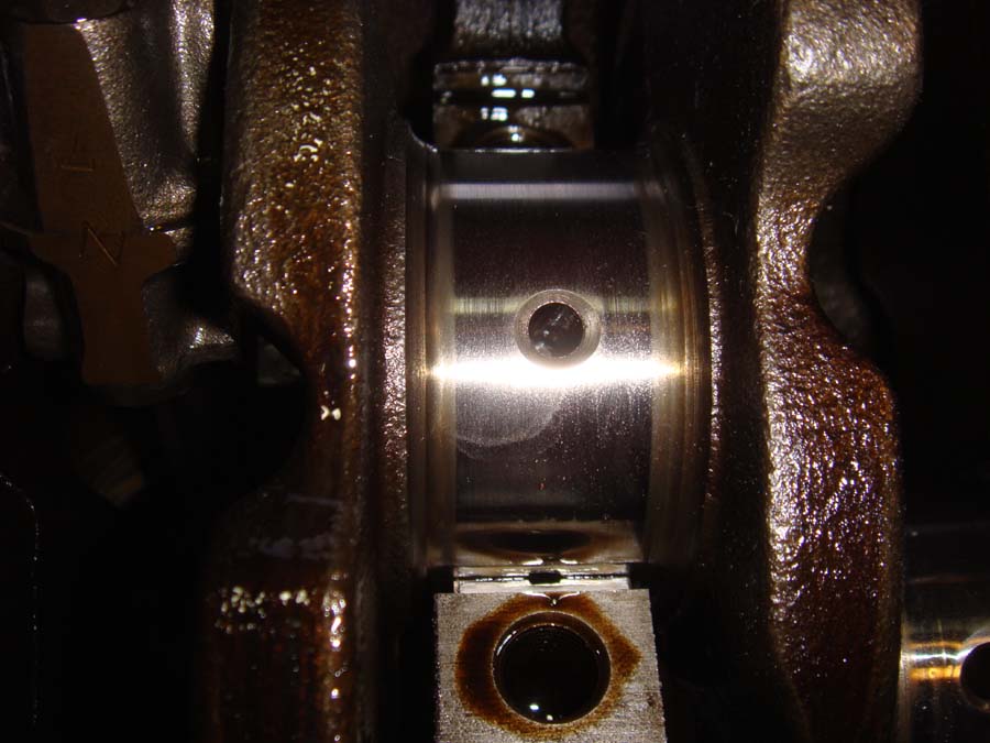

    Question:

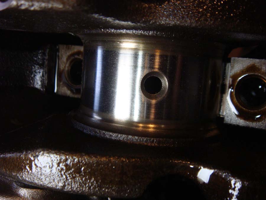

    Is this normal for a main bearing fillet on one of these engines?

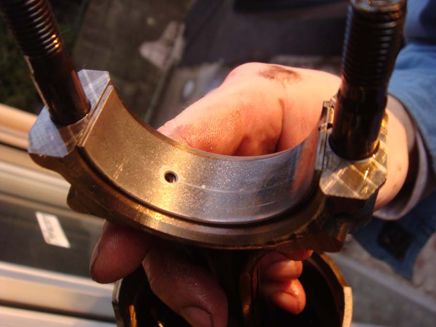

    Additional http://www.3sgte.com/Carina/DSC0328211.jpg
    The bearings were in awful shape.
    For some reason the bearings look better in the pictures than in real life.

    3sgte- bearing looks like a million particles embedded into the bearing shell? wouldn't be too surprised at this considering the piston looks like it's been driven on since going bang. suspect that the oil pump and cam bearings will be similar. the oil filter when cut open should show what's being pumped through the engine. having a failure such as this can clog the filter and likely open the bypass or filter element collapses.
    -Mark

    Yeah, the bearings are not pretty.
    They have a gritty texture to them.
    Good call on cutting open the filter. I'm sure it is pretty sparkly in there.
    When I saw the first bearing I nearly cried for the crankshaft, but the crank looks a whole lot better than I would have expected given the bearing condition.
    I haven't given serious thought as to whether to regrind it yet.
    Not having a machine shop that I know and trust makes that decision harder.
