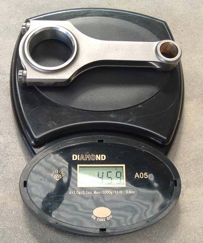

    just thought people would find this usefull:
    its the 4age model
    I have a modified 20v set that has been ground+shotpeened with arp bolts that weighs 501 grams so -42 grams so sorry I said the wrong amount before

    and ae92 gze is 526grams
    700grams in total and then with lighter pistons "wow wi wow wha"
