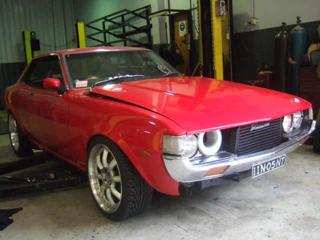

    YES!!!!!!!! i couldnt find this thread to update it before! heres some pics from my rides thread.
    if the other strut magically comes together, i should be able to roll it round the block for its 1st drive in 14months!
    its running a 30mm bolt on spacer (which is alot bigger then what i thought i would need!)
    also the camber tops are dialed all the the way in, and only has a few deg of neg camber, (may look into ae86 neg camber RCA's)
    STRUTS/BRAKES CUSTOM MADE BY LINDEN AT ROAD RUNNER FABRICATIONS
    (free plug )

    absolute PITA to make it work but as per usual persistance paid off, 1 set of brackets left over if you need them, wont bother getting any more done unless i get an order of 10 as the amount of design time i put into them didn't pay off for the 4sets that i ended up selling.
    BTW, blakes ones are for r33 discs and calipers not r32.
    linden

    craig, you will be able to get away with a 25mm bolt on spacer,(should leave you 3-4mm away from the strut) ive got a 30, as they were out of 25's
    ive got my camber dialled all the way in, whick is about 1.5-2dg, havent had it on a wheelo yet., i may still use some ae86 camber RCA's but will have to go for a thinner spacer (25mm) so the wheel still sits in the guard.
    fingers, yep, uses teh xt130 hubs/struts, hubs are slightly machined for the r33 discs to slip on the back. the discs also need new locating bolt holes drilled.
