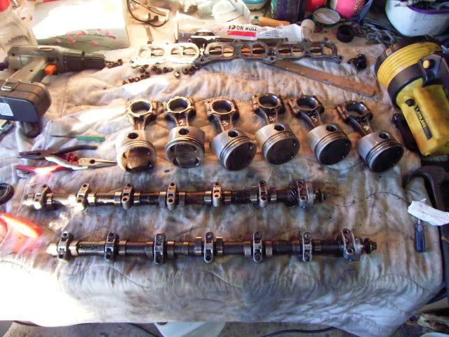

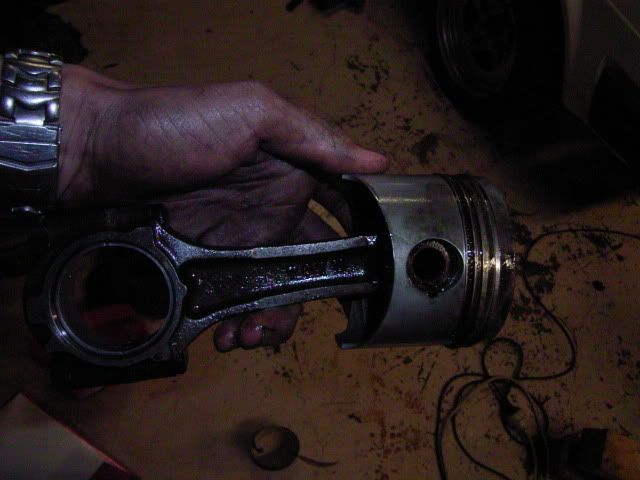

    theyre the only ones i have, never took on looking up its skirt....im not into that sort of thing
    doubt they are any use, but thought i would put them up anyway
