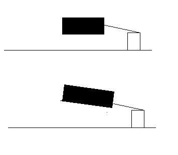

    i've rebuilt the carb and put it back on the car now but im having trouble starting it. I've checked spark and fuel and cleaned up plugs and points. I used some aerostart and it started for a bit, but as soon as i opened the thottle a bit it died. I'm pretty sure the carb has been connected up properly.
    The only thing i really changed wus the float valve. I adjusted it by turning the top of the carb upside down, and making sure the float wus parrallel by sitting there under gravity. I also blew into the fuel inlet while upside down and it wus closed. Before i adjusted it was way off and i drew a diagram of how it was (bottom).
    so i adjusted it a great deal to get it looking like the top. After putting it back on the car and cranking it, however, the fuel level is much higher than the sight glass. So i'm thinking the float chamber is filling up too much and the engine is getting flooded.

    Yup, fuel in the bowl should be level with the center of the window.

    Hi there
    Did you use one of those rebuild kits part no. A10L that replaces AN-111 for Aisan carbys?
    If you did, on the bottom right corner of the sheet that comes with it, it shows the float
    level of 7.1mm and from my experience found that level way too high.
    the diagram you drew, the top float level is closer to what it should be.

    Well i just took the carby off and the intake had about half a centimetre deep of petrol .
    And when i opened the throttle petrol just drizzled out. Could it be something else other than the float because i dont think the float valve is working and petrol is just constantly going in.
    Yes i think thats the rebuild kit i have, Mike, but i did adjust it so it looks like the top of the diagram.
    The float needle in the rebuild kit wus a bit different to the stock one so i'm gonna change it back to the stock one and see if that works. I hope its just the float thats giving me problems .

    Good news, she runs!
    Altho rather rough, and smokey and noisy... she runs!
    First time ran in about 9 months and after the carby rebuild...
    The problem was the float. Firstly it wouldnt close and so it just kept pumping fuel and it wus overflowing into the intake. then i pulled it apart again and adjusted the float, put it back on and it still didnt work . Then the 3rd time i adjusted it so it would close at a lower level. Put it back on and it no fuel wus going in at all! x2.
    so i pulled it off again and took it apart and adjusted it again....
    And it ran! Altho the fuel level isnt too good still as its a bit below the sight glass. But im pretty happy after the 4th time of pulling it apart.
