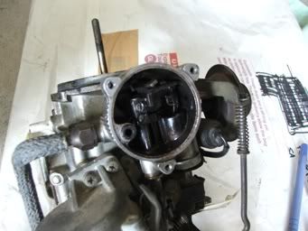

    I have run into something i dont understand. My choke wusnt working properly cos i had to hold the throttle open to keep it from dying in idle. When i pulled it off i noticed the choke wus always open:

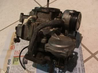

    So i figured i could just fix this in the rebuild. But my issue is that the choke housing doesnt have any hoses going to it or out of it. (previous owner):

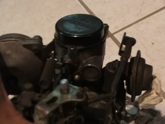

    ^^^that hose coming off the choke housing isnt connected to anything.
    ^^^the outlet of the choke housing is just closed
    Looking thru the diagrams i have for the carby, the choke housing looks different. Did the previous owner put another one on? anyone got any suggestions on making this choke work properly?

    Default Re: 18rc carby issue
    the choke housing uses heat from the zorst, not coolant... that pipe should go down to a fitting on zorst manifold below the carbi.
    suggestion? go to an auto-parts store and get the cheapest, generic, manual choke kit on sale and adapt it to your carbi. You might be able to adapt something that you find from a wrecking yard.

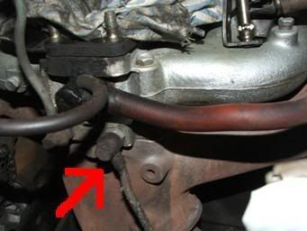

    is this what should be connected to the choke? cos right now its connected to nothing.
    If thats so can i just do that?
    But what about the outlet?
    yes - that should join the line on the carbi

    nah - big red pipe is vacuum - the two smaller heat tubes go into the heat exchange area between the zprst & intake.

    You've got a problem with the choke always being open, not closed, so
    getting some hot air/heat to it won't do anything to help you right now.
    I'd just adjust it, and fool with the hose later if it doesn't seem to 'come off of choke' soon enough when warming up.

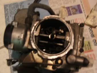

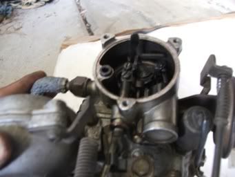

    heres some pics with the cover off:
    I'm pretty sure its exhaust actuated. when the bimetallic strip opens up.
    edit: i'm wrong the exhaust doesnt get into the choke itself. I think it just surrounds it and by conductivity the bimetallic strip heats up?
    The strip doesnt actually open the choke tho. Anyone know how the choke lever is actually forced open? because its not the strip that forces it open.

    Hi there, you'll probably find the choke breaker/opener diaphram is at fault not
    neccesseraly the strip that heats up. I had similar issues when i was running an 18-rc.
    choke breaker diaphram isn't part of any rebuild kit so replacing it is next to impossible.
    grab a peice old spare vac tube, one end on choke breaker then suck on the other end,
    while sucking put the tip of ya tongue over the end and see it it holds.
    another alternative is to get one of those 50ml syringes from an auto store and use that
    for suction and watch what the diaphram does.
