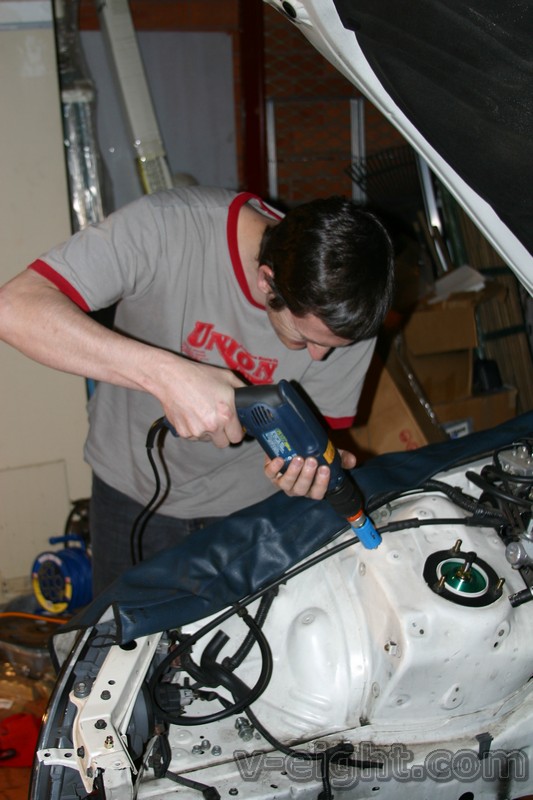

  13. #208
    Default Re: 1UZ-FE VVTi into IS200
    "what do you mean you don't want a hole there????"
