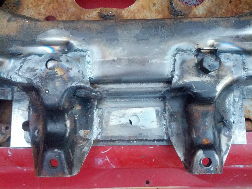

    Finally got my arse into gear and now the crossmember and steering column are nearly done:
    TA22 crossmember with KE70 rack mounts to suit a 70mm shortened rack.
    Yet to see fitment with regards to engine sump/bellhousing bracket clearance. The steering column looks to mate up fine to the rack without any issue.
