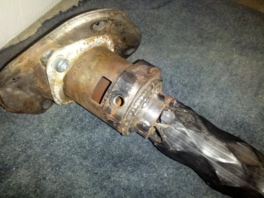

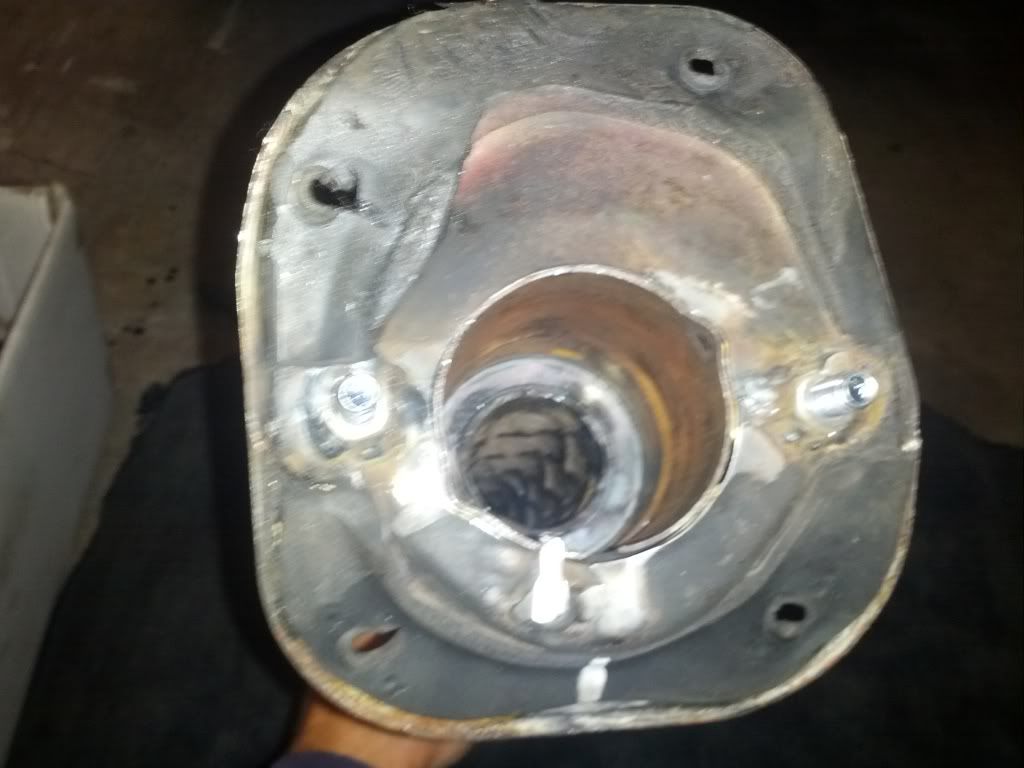

    Stidnam, my plan was to cut a thickness of the bearing off the end of the TA22 housing, and weld a tube with an ID to suit the lower AE71 bearing. To stop the bearing falling out, a little thrust plate will be made up to slide over the uni-joint side of the bearing. While this is a little more complex than just using a bushing, the bearing will last a lot longer.

    Yeah already realised the firewall bit is going to need modding, basically going to replicate what it already is but a slightly larger ID to fit over the bearing spigot. An extra U-shaped thrust plate will then slide over the back of the bearing and bolt to the engine side of the firewall bit to stop the column falling out. The engineer seemed to like the idea
    As for "gluing" the collapseable column back together, what has everyone else done? I was just going to drill holes in the AE71 sleeve in the right spot for the divots on the lower of the TA22 shaft and fill with araldite using a syringe.

    what I do and suggest is to chop the whole bell end off the ke70 column and weld it to the ta22 column. No machining needed and it's quick and easy. To adapt to the firewall use half of the plate off the firewall from the ke70 and half of the ta22 welded together.

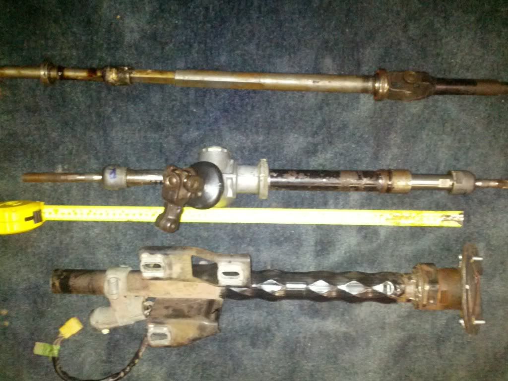

    Here is some pics of how I did the steering column:
    The AE71 rack is now ~510mm end-end:
    Still got to chase down new bearings, tie-rod ends, rack boots, rack bushes & still have to do the rack mounts on the TA22 crossmember.

    you have done well, that should work without any problems at all.
