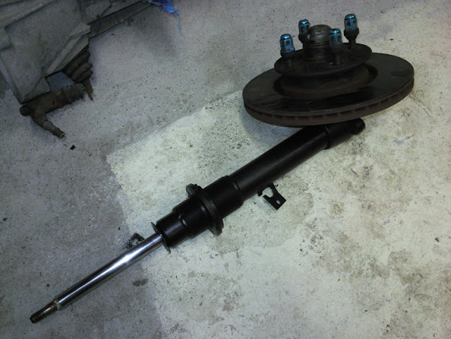

    This shows how it all looks..
    Which equals this height ..

    I probably wouldn't only as I want to retain some suspension travel. which was my reason for cutting so much out of the tube.. I found with the strut the standard length it was all compression, no droop.. not ideal..
    I am using KYB AGX which were around $400 for the pair..
