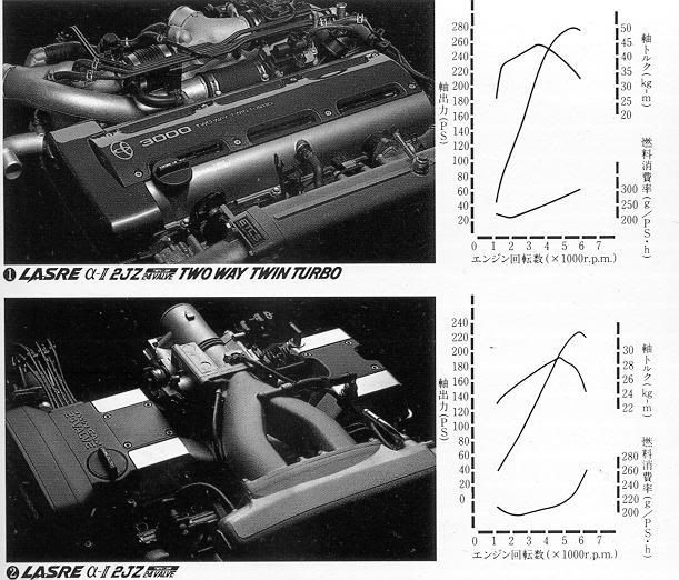

    Oh What a Feeling! Backyard Mechanic c2888's Avatar
    332
    Default Re: 2JZ-GE torque dead spot
    cut/paste winnah!
    Last edited by c2888; 05-10-2006 at 06:19 PM. Reason: changed tag to point to photobucket
    um, whats that for?
    and.. the 2jzgte doesnt even have ACIS
    Because the bottom graph is a 2JZ GE, look at the runners and the peak PS figure.
    Also an interesting torque reading. (i assume the Ps/h is torque)

    Quote Originally Posted by ed_jza80
    um, whats that for?
    huh!? i swear the image i was quoting on changed from what was earlier a 2jzgte ecu pin diagram! lol! im going mad!
    current image makes much more sense! lol
    Yeah, i had thought the same at first, then when i looked at it again it was the torque curve and now its just gone.
