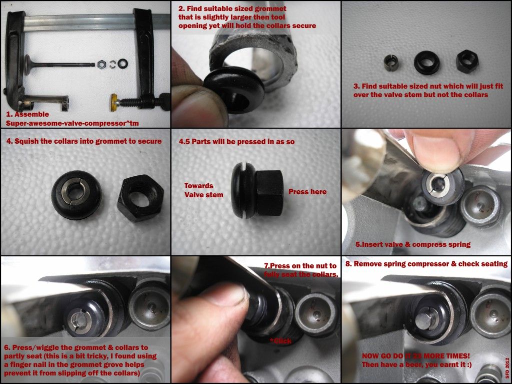

    Came up with this nifty system to install those pain-in-the-ass valve collars the other week:
    Worked like a champ once I got the hang of it.
    Took around 30sec per valve & way less swearing then fumbling with needle nose pliers and screwdrivers.
    -A

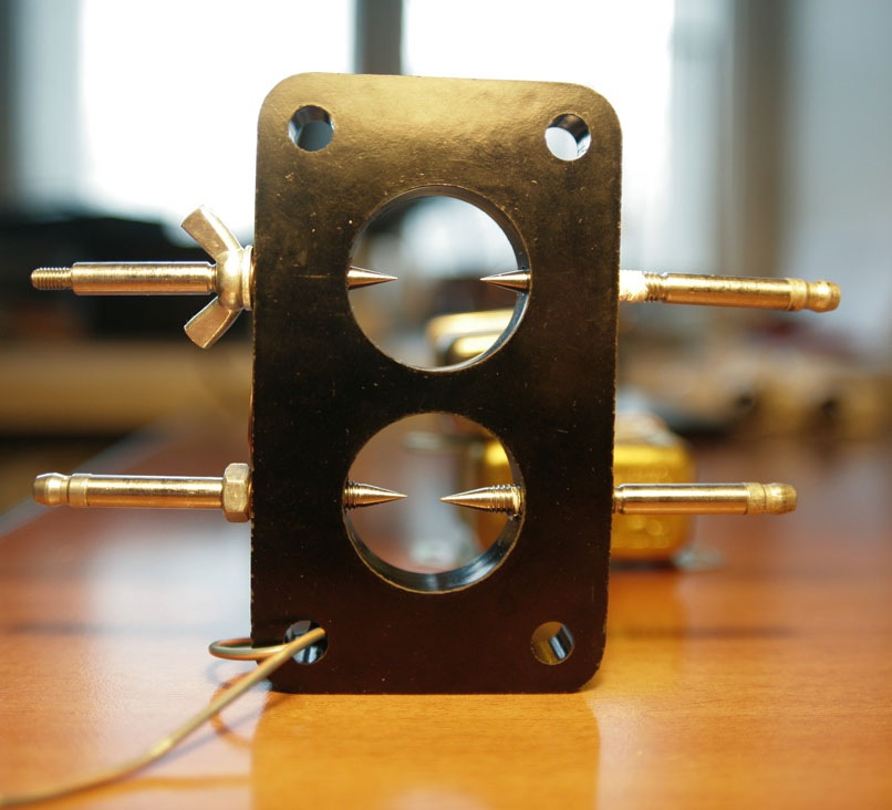

    A simple tool to reliably test your ignition system. I recently fabricated and tested one and thought it may be useful for others.
    Some background. There're some ignition system failures quite hard to detect, cause you can actually see a spark, even engine would idle fine but miss under load, or even have a bit poor driveability and mileage. That usually occurs when there's not enough power for spark. The tool is used to make sure that your ignition can fire 25kV arc. That's enough for n/a and most TC'ed engines.
    The tool consists of 2 spark gaps: one to generate "weak" spark and the other to test for maximum power. These are 7mm and 17mm, correspondingly. It's made of carby thermal insulation plate and 4 rods, but there're many other designs, you just need a gap and a good electrical insulation.
    To run a test, you connect one rod to one high voltage output (that normally goes to a plug) and the opposite rod to the negative battery terminal, then crank the engine. Note that every other ignition output should be connected as usually, do not leave them unconnected, that would damage coils/igniter/whatever else. If you can see spark in 17mm gap repeatedly, then the lead under test is fine (as well as its coil, igniter and wiring).
    http://a.d-cd.net/7a020c8s-960.jpg
    [EDIT] added video clip
    http://youtu.be/29pUlhIwm_s
    here, first coil output is shorted, the other one (that with HV wire) is tested for maximum voltage
