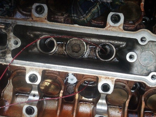

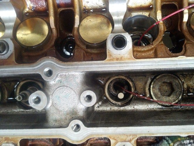

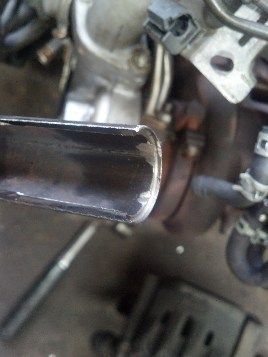

    I was doing my valve stem seals on a 2jzgte

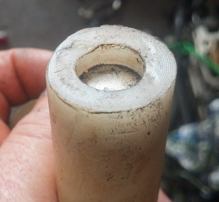

    Here is the retainer/keeper remover with a powerful magnet down the hole in the end of a piece of plastic . Works well all it needs is a rap with the hammer and the retainer and keepers come off the valve and stick to the magnet
    I tried copying an inserter which did not work too well for me so I made my own, Bored out the end of a piece of pipe to fit the retainer , cut a hole so I could get at the keepers and it worked well. Leaned on the upper end of the pipe to depress the spring
    I was down to the last 2 valves and was looking forward to going home having completed all 24 when I hit the wrong valve and dropped the valve straight into the cylinder.
    As I thought this may mean head removal I uttered a few demeaning words shut the door and went home to search Ebay for a head gasket.

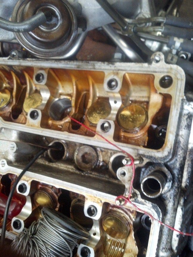

    Not to be outdone by a valve sitting on top of piston number 5 I came up with a devious plan to remove the errant valve thus avoiding head removal.

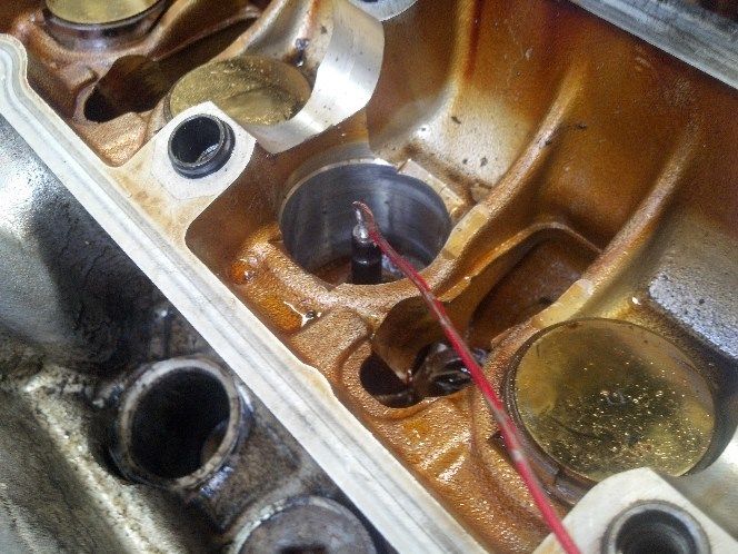

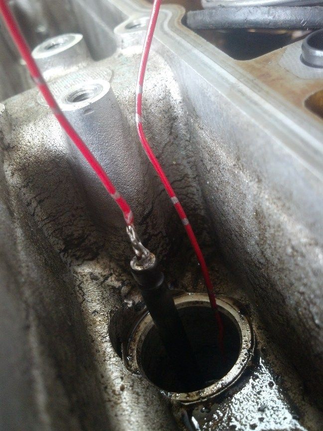

    I threaded a copper wire down through the hole where the valve had been and back out the spark plug hole
    I then moved the valve to the spark plug hole and rotated piston number 5 to TDC
    I then soldered the copper wire to the top of the valve

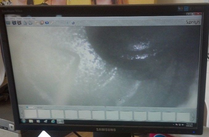

    I then moved the piston to BDC and then proceeded to pull and push the valve back up through the valve guide with a lot of help from a borescope and a piece of wire
    I was able to get the valve back to where it was
    A couple of keepers disappeared down into the bowels of the motor along the way and were easily replaced by a couple I scavved from a 4S head I had lying around
    This information may help some poor unfortunate fool who did what I did
    I recommend taking lots of care when undertaking something like this
