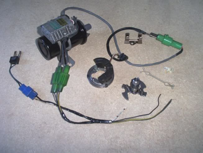

How to fit new Dizzy, coil, & igniter.
1. Connect / solder, the thin Black wire, from the igniter Green plug to the Black wire going to your taco. Then tape it up.
2. Connect / solder, the White/Black wire, from the Blue plug on the noise suppresor, to the White/Black wire, ground -ve, you found when undoing the tape, near the old dizzy. Then tape it up.
3. Connect / solder, the thick Black/Yellow, ignition +ve, to the thick Black/Yellow wire, from the old dizzy. Then tape it up. ( Note: RA60 has Black/Red wire, from the ignition )
4. Tape up the Black/Red wire from the old dizzy. As it's no longer used.( It can also be disconected from the starter . NOT the Black/white wire. )

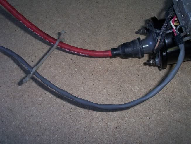

5. Retape, all the wires up, back to the motor, & the chassis loom. ( Note: you should not tape up the new Gray, twin & shielded cable, that goes from the new, coil/ignitor, to the dizzy. this will just hang, or ( if avalible, use the two other, " Toyota " plastic clips, to hold wire safely ) from the coil/ignitor, to the clip on the side, of the dizzy. )
6. Move the rotor button, of the new dizzy, to the resting position, of the old dizzy. ( Note: This should be, just before #1, as it will spin slightly as you slide it in. )
7.Now holding the new dizzy, in the same position, as the old one was removed, slide the dizzy in, watching out not to damage, the "O"ring. A small amount of motor oil, on the "O"ring will help it slide in easier. ( Note: The tongue at the bottom, of the dizzy shaft, must line up with the slot, in the oil pump, for correct fitment. )
8. Rotate the dizzy a bit, to line up the rotor button, with the #1, spark lead on the rotor cap. Refit the clamp & bolt.
9. Connect the Green plug, from new coil/igniter, to new dizzy, & place in clip on side of the dizzy.
