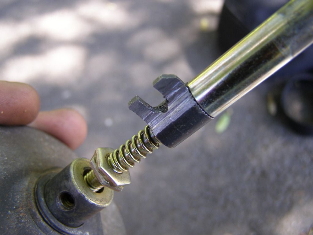

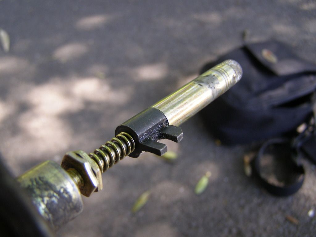

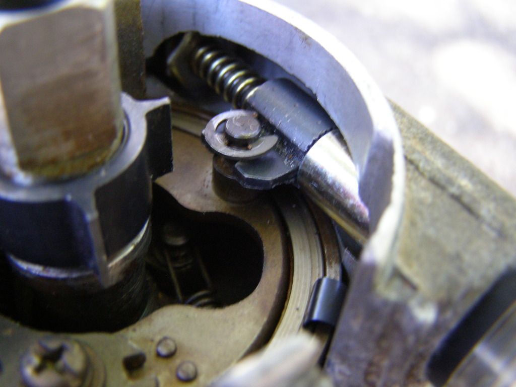

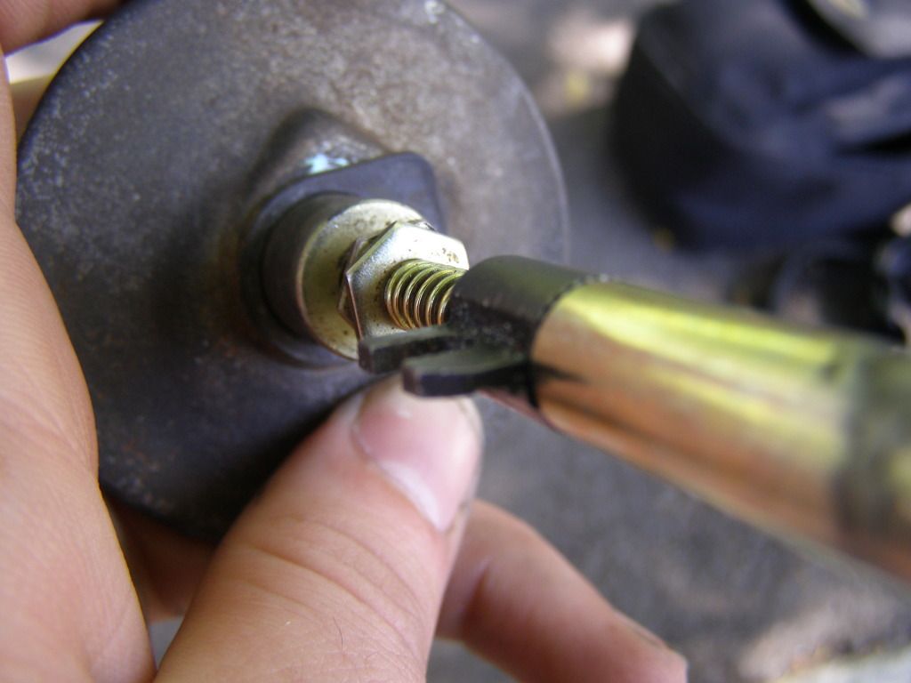

    ^ I did that.
    Hope that helps

    COOL... Thank You...
    thatwill help many modders..
    But you do Not need to grind it that much..
    you only need to grind enough to fit under the "E" clip

    Yeah I got a bit carried away... My bad!
    I actually fit the clip on there without filing it but it was a bit tight.
