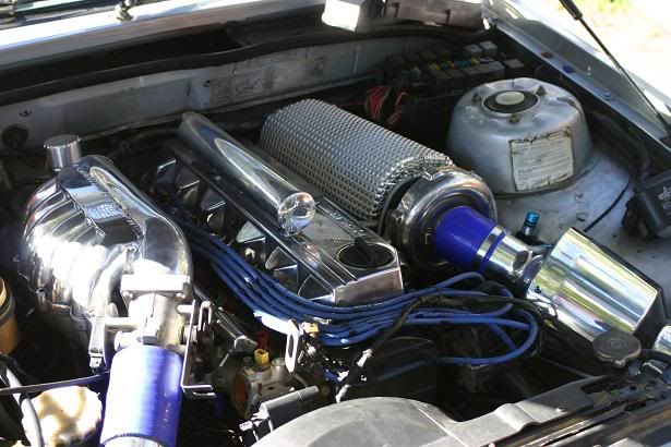

    Junior Member 1st year Apprentice hybridaddy's Avatar
    Jun 2006
    40
    Default Re: Catch can return line?
    this is my daily driver setup.
    i made the lot myself including the drainback catch can which works well.
    its full of stainless steel wool to seperate the oil air mixture,i havent had one drop of oil come out of it so far
