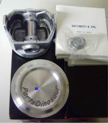

    Default Re: 18rg 2.2l ???
    hey im doin this build right now the only reason i am using these pistons is cause i dont have 1000 to spend on 18rg pistons
    but yer anyway im a bit worried that i have cosen the wrong pistions
    the ones you guys are talking about do they like have a ring on the top then go down in the middle? i tryed to find some that look like the 18rg pistion but the ones i have just look like they go up then have a mass whole in the middle
    is this the right piston ??
    this is the pistons i have
    Have you got a side on view the top view doesn't show much. I think your going to have issues with valve clearance. Are they 22r.
    yer there 22r pistons ill try get a side pic
    also im getting an engeneer to build the engine and he is going to do the valve cut outs into the piston
    he also did the maths and the comp ratio is going to be close to standed the only gain i will get is with going to 2.2L
    So they have the 24.7+ dome i tried using them for my turbo conversion but when i went to get the fly cut he tested them them for thickness and they become to thin but yours might be different mine were wiseco.
    yer these ones are just standed replacement pistons he tested them to and said there is plenty of meat there
    do you still have you pistons or did you end up useing them??
