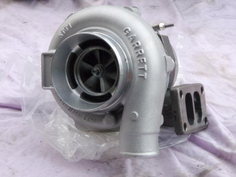

				depends what your after. i just finished my single conversion on a 1ggte and used a gtx2867. i love the extra responce on the street and im getting possitive manifold pressure at 2000 rpm. im only talking 3 or 4 psi put that makes a big differance. that turbo will run as much boost as you want but in a street car i like boost as low in the rpm range as possible i rearly take mine over 6000 on the street and will prob never see the strip. if you want the most hp and best 1/4 mile get a big turbo. if you want a street car have a hard think about something 28 based. its only a 2L remember.

				i actually dont have a peak hp figgure..... i told the tuner i didnt care about peak hp and all i wanted was the fattest midrange possible. Im heading back out there next week so ill ask for a printout if they have it on file. he did say that when we played around with cam gears to fatten up the bottom i would loose 15-20 kw at the top but that didnt bother me. id say i have 205 or 210 rwkw but who knows. it's a little old car running a little over 20psi threw a little turbo on a strait 6 with an LSD.....
