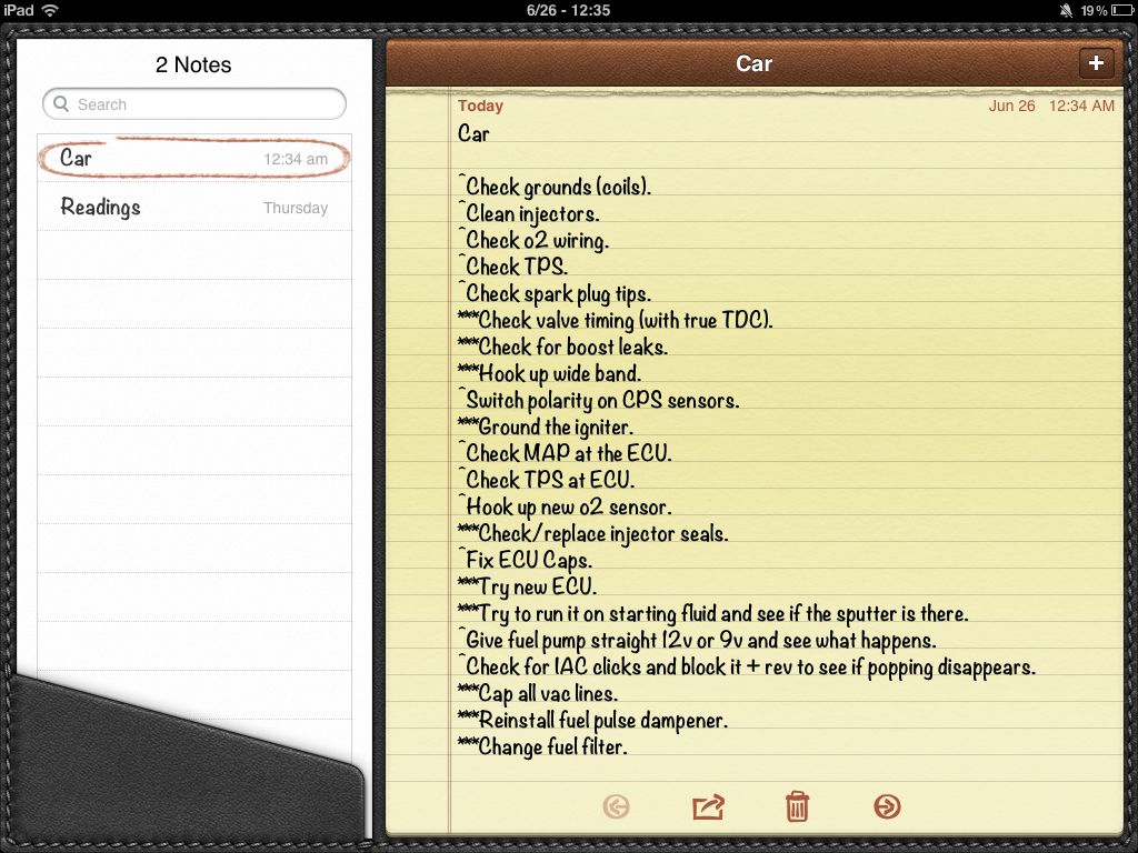

    Repaired and made no diff. Gonna try a different ecu soon.
    Sep 2011
    FL
    32
    Default Re: [UPDATE!] 2JZ-GTE Swap into MA70 - Misfiring issues - Will PAY for a correct answ
    *** = todo
    ^ = done
