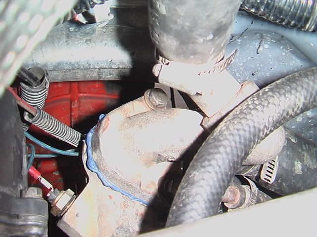

    this is the one that i took apart and found no thermostat (its a public holiday today here thats why i used permatex to reseal it)

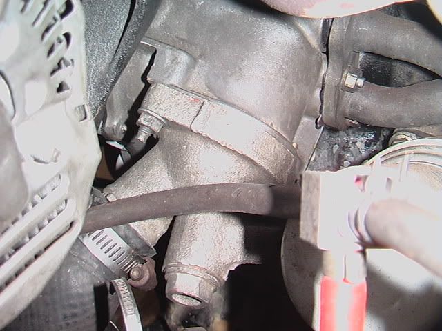

    ok this is what looks like another tstat housing that comes off the bottom of the rad (i havent takin it off yet)

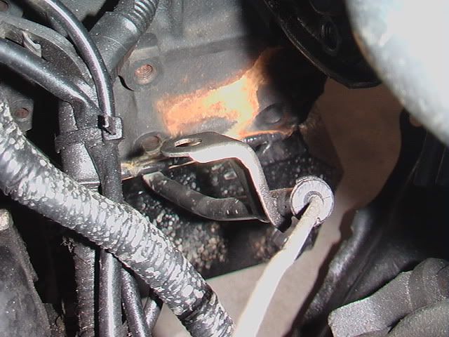

    this area seems to have a slight leak. water pump seal??

    what motor is this on? the 2nd pic is definately where the thermostat is.
