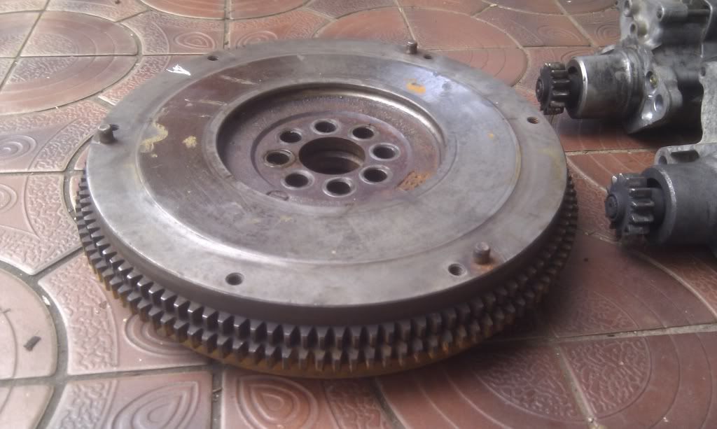

    http://i1230.photobucket.com/albums/...t/IMAG0063.jpg
    FE flywheel on the left GE on the right, notice the lack of marking on the FE around the crankbolts...
    http://i1230.photobucket.com/albums/...t/IMAG0060.jpg
    3SFE flywheel on the bottom, 3SGE on the top, IT WAS FRICKING SMALLER! Oh well problem solved.

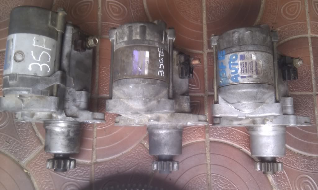

    http://i1230.photobucket.com/albums/...t/IMAG0062.jpg
    A shot of the different identical starter motors (excep one plug) from left to right: 3SF, 3SGTE, and a 5S item.
