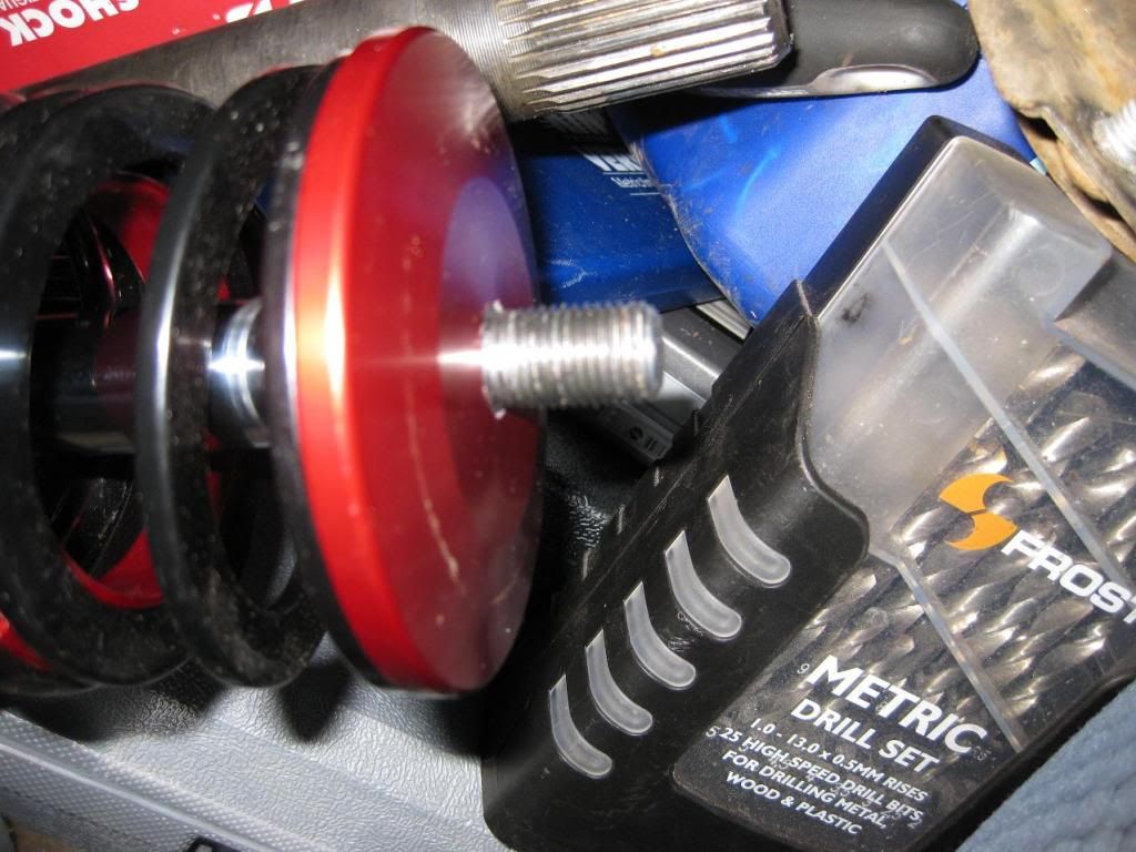

ok run into a little problem. Using ra60 struts and mr2 shockies and hsd coilover kit, gone to put the top spring plate on and then the standard strut top on, there doesnt seem to be enough thread to get the nut on, as in you can get it on but only a couple of turns. Suggestions???

is the top spring retainer seated correctly?

i think so

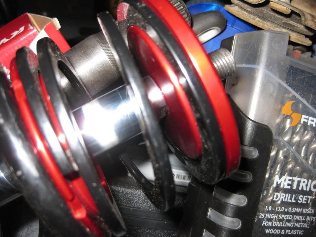

mate, the retainer doesnt look like it is sitting flush on the collared section below the thread. when looking at the second photo, you can see there is still some room to move before it is located correctly. Does the spring retainer have flat sides which slide on the struts shaft?
Upper hats have to float on the shaft, drill a bigger hole in the upper hat so the orginal tops (if that is what you are using) move down into position on the D of the shaft.
Hope that makes sense but basically you need a bigger hole.
