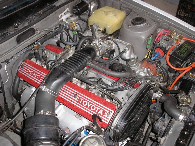

    time frame....meh.... when i get all the parts sourced....budget, goin on the fact that other then coating and machining different parts the only thing i need to pay for is parts.... i would think in the figure of 8 - 9k.
    i am looking at more then just wackin in mega power (1j or 2j). i want to make it a sort or retro resto.
    i have a MA61 'matchbox' car that my car will be modeled off.
    so al in all it will cost alot and take ages.... however end result will be pretty sweet(i think anyway)

    does anyone know if ITB's have been put on a 5MGE as this would be a great help... being the same head and all

    Hmmmmmmmmmm,
    since you are going with the 2 valve head, I'd think the ITB's from the silvertop would do.... you will have to have a custom intake made... and try to figure out the linkage to the 2 additional throttles.
    Not knowing all of M engines... isn't the 6M basically a 7M bottom end with a 5M head? If that is the case, I'm sure you can get a nice crank somewhere.......
    Do you have a spare head? You might want to get it cut through the combustion chamber(3 cuts ideally - 1 in the center, and 1 cut each through the valves) to see how much room you'll have for porting.
    Custom pistons are just $$
    Hmmmmmmm 2ndary brainfart here.... the 5M was a very good torquey engine, have you thought about making it supercharged???

    A few years ago I rebuilt the old 5/6m engines used in Peter Williamson's GpA Supra. The cams were TRD custom ones, nothing like I've seen from any of the mass-makers , but I could re-make new ones if we can find blanks. Duration about 320 degrees and 8mm lift from memory. used custom Cosworth pistons and Carrillo rods. It used a single TB as thats what the rules required.
    These old engines ran on very primitive ECU's so anything decent made today would be OK. it mostly depends on how much extra stuff you want the ECU to drive, eg shift light, cold start, fans etc etc
    I have all the tech info at work and will be able to help out.

    i love the lok of the heads... if i can get mine pretty much a bar engine with nice extractors(and side pipe) and the other ITB's i will be a happy man....
    i love just seeing an engine not covered by vacum lines and other random crap...
