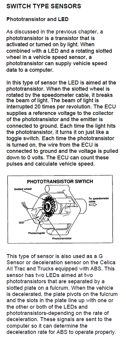

    As said it is a phototransistor & LED pair.
    Not Hall Effect.
    It will need power to work!
    I.e.
    http://www.jaycar.com.au/productView...s&form=KEYWORD
    See page 7 in the below from autoshop101
    15 Overview of Sensors & Actuators w/quest.pdf file size 287KB

    I don't know what the exact signals are, but you need to be aware that most photo transistors - including the toyota photo transistor we are talking about here, are what as know as "Open Collector".
    And that means that they can only sink current, not source it. Read below
    http://en.wikipedia.org/wiki/Open_collector
    You will want to connect a pull up resistor (1-2k should be fine) to a voltage source and then use the multimeter to measure the square wave voltage output...
    Or you can put your multimeter in Ohms mode and check to see that you see low resistance, then high resistance as you turn the interrupter wheel...
