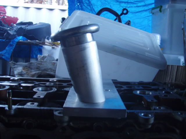

    here's the dilemma. building a 3sgte and don't know which head to use. previously only had the gen2 NA head to play with (don't want the gen2 TVIS head) and so started making an inlet manifold for it. but know i got my hands on a gen3 head for cheap.
    plans for the build was i wanted it to rev hard 8-9000rpm making decent power/torque up in the top end. also i wanted it usable for daily driving and track/motokhana(it's going in an sw20 btw) hence the turbo recommended for good flow in top rpm was a gt35r with 1.06 rear. obviously this sucks for any power before 5krpm, so the plan is to go sequentials with a gt2560 for initial low end boost.
    here's pics of the inlet mani so far. short runners for top end, hopefully the little gt2560 will give me enough and overcome the horrible torque hole the short runners give.
    gen2 ports
    this is the same plate against the gen3 head, the gen3 ports are marginally shallower in height but wider.
    this is the gen3 inlet gasket on the gen2 inlet plate(the gen3 ports are a little smaller than the gasket.
    and here's the gen2 head on top of the gen2 head
    comparison specs:

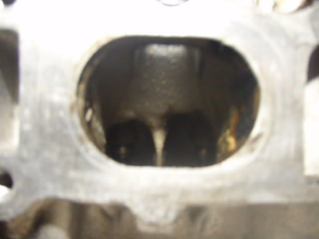

    gen2 ports size 48x35
    gen2 "ported" size 51x36(this is the size of the inlat manifold plate i got made.
    gen3 ports 56x33.
    the gen2 ports are "higher" in the head meaning the ports are angle more straight down into the valve inlets approx 15deg from horizontal.
    then gen3 has a shallower angle so the ports aim more at the valve stems approx 8deg from horizontal.
    so the Q;s are, how much does the angle of the ports affect flow into the bore.
    how much does the port shape affect airflow, the gen3 being more flat and oval with a funny kidney shape, gen2 more rounded.
    the gen3 ports are bigger would this be better for top end or would this not matter so much with the short runners and a big gt35r forcing crap loads down its guts?

    thanks for the link's and reply's. i've no doubt that a good port job by someone that knows what they're doin would yield excellent results.
    my question is which head do you think would be the best base to start from? ie: which head given the different port angle, size and shape would i best spend the odd 1k on for quality port work?

    well both heads are oval, just one more so, but according to this the gen2 head has a more down draft port and hence better...????
    http://www.guy-croft.com/viewtopic.php?f=2&t=199

    the taller the port the higher the potential velosity before choke, this means that for the same given cross section the more upright port will flow considerably more air. So in a direct comparasin for two engines who both have the ports just big enough to not starve the top end; the upright port engine at low to mid revs would still have a high velosity due to the smaller cross section. This is before you even count the reduction in eddies + turbulence and the change to a more ideal venturi port shape.
    Upright = win

    You want to use the head with the bigger downward angle on the ports as the starting point.
    It may not flow as well in stock trim (just a wild guess here though), but once you begin porting the head, it will blow the shallower port angled head out of the water.
    On my 1FZ head, the inlet ports are at approx 30 degrees down angle, and the exhausts are flat like a 2J
    My head porter went to town on both the intake and exhaust ports - we also have oversized valves in it.
    The exhaust port has a larger x-sect and larger valves than a 2J, and when the all-out 1FZ ex port was compared to an all-out 2JZ ex port, it flowed a predictable 13% more than the 2J. (remember both ports are flat)
    On the intake side, the differences between the x sect and valve sizes of the two worked heads (1FZ and 2J) was the same in ratio as in the exhaust ports, HOWEVER the 1FZ has canted inlet ports and the 2J has flat inlet ports. The difference in flow between the 2 ports was almost 35%........
    Obviously that shows the huge difference canted ports make - and the more the better (up to a point obviously - but you are nowhere near the limt)
