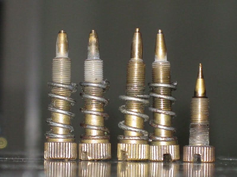

    From a PM from Killa so all can relate and may relate to Twenty6's issue
    Quote Originally Posted by Killa_Ta22
    im haveing some problems with my 2tg motor.
    the car hasnt been idleing properly or reving properly, if you rev the motor it takes a while for rev's to drop. it coughs and farts out of the carby's or exhaust.
    comppresion test was 120psi and number 2 was 100-105 (cold and semi warm)
    so
    i replaced
    new coil with ballast,
    plugs
    ordered new leads
    both electronic and normal 2tg dizzy doesnt make a change
    have set the timing between 12-16 BTDC
    fule pressure has been around 3-3.5psi
    ventruies are all nice and tight.
    i took the top cover of the carby's off and check that (going off your website)
    the two small jets are 57.5 on all of them(pilot jet??)
    the top small ones that are screwed into the big long jets are 130's(main air jet??)
    once those ones are off the long ones have a 8 on them. (jet block)
    i took the long jets out and they have 130 underneath of them.(main air jet)
    and didnt look at the bleed pipe
    the idle mixture screws dont look to well, the first carby still retains the long needle point on it, then the other 3 mixture screws dont have the needle pin on them, there missing. seem to have broken the pin point.
    silly car chick thinks that the cam's arent setup correctly or timing chain issue due to lower compression.
    i dont have any history about the motor, it seems to have modifyed cams in it for the way it lumps or that could be due to the fact the mixture screws on 3 of them are stuffed???
    also on top of the carby number 1, it has this vacume thing which is the bracket for the choke, it doesnt seem to do anything so i just put a bung on the balance pipe.
    a pipe runs off the bottom of balance pipe to a canister under neath the manifold. dunno what that is
    i dont know what else i can do. but its not running well at all.
    First thing to look at, are the tips of those broken idle mixture screws are still lodged into the idle hole? A torch shone down the screw hole will either revel a plugged hole or you will see down onto the throttle plate. Compare them to the one not broken.
    The tips break off when the screws are seated closed too tightly, they break off very easily and as they have been tightened the tip has been jammed into the hole.
    If the Idle holes are plugged, then the motor will never idle or progress from idle as those three cylinders are getting no fuel from the idle circuit. The bypass circuit and the balance tube assemblies can compensate only a little and hence the reason the motor can be started as one idle circuit is supplying all four cylinders.
    It will be an absolute prick to drill out the plugged holes. I have done it and it takes a good drill press or mill to square up and align the body to drill them out. They are from memory 0.8mm holes but check the good one.
    Otherwise it is another pair of bodies to transfer all the good bits into.
    Regards
    Rodger

    edit - ^ those are the mixture screws.
    So I took the carbs off and looks like they are all broken, 1 carbs both holes are clear the other carb has both tips lodged in and I don't think they are coming out... Can anyone confirm these are 0.8mm holes? Angry :@
    If I clear them, where can I get 4 replacement mixture screws the same type?
    Nice troubleshooting.
    614
    Default Re: Solex sidedrafts - High Idle!
    The one on the far right looks fine. The others have all been over tightened too many times, bugger!.

    I have yet to confirm the hole size but a couple of tips that will help drill out any plugged ones. If you have access to a good range of small drill bits in 0.1 steps then try them in one of the clear holes to determine the hole size for your carbs.
    I have drill sets in 0.05mm steps from 0.2-2.00mm, hard to come by but available.
    Set the carb square on the table.
    Use a 4.5mm drill bit, the prefered tap-drill size of the 5 x 0.5mm threaded hole (or one that fits in well enough), turned upside down to align/centre the body with the drill chuck.
    No use a smaller bit to the one that matched the hole size to start with.
    Lower the drill onto the plugged bit of brass and turn by hand. You may find that you can remove the plug as the drill bit bites into it. Otherwise continue by hand to drill through.
    Then check how centred it was and use the prefered size to grab the plug as it now could come free.
    If it goes well the hole need not be touched or drilled completely. If goes badly all four holes can be drilled to the next size. It means the idle mixtures become a tiny bit more sensitive to change when tuning but will still work.
