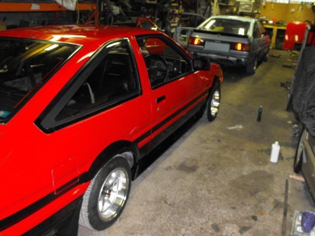

    I'm in Ireland dude, black 94 ae101 levin GT-Z superstrut. Have a bluetop R/O/B jap ae86 aswell tho
    Like Oz, there is a huge following of Toyotas in Ireland. However there are a LOAD more
    AE111 BZR BZG Levins than ae101 here, but of the ae101's that are about here the majority are GTZs, only ever seen 3 ae101 20 valves
    The ae101 is a far nicer shape IMO to the AE111
    Past year I've come across about 6-7 GTZs for sale in Ireland, we are Toyota freaks here tho
