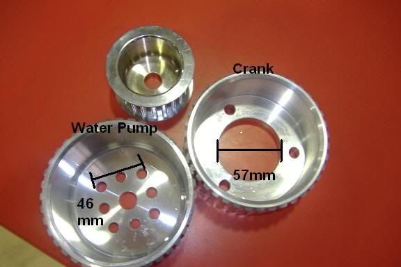

    Which one is the water pump? I assume it is the bottom one?

    Naa thats the one at rare spares...yep the one with 9 holes is water pump...going in to measure the water pump bolts now..

    Ok just measured the water pump bolts and from center to center they are 40mm, 45mm outside of the bolt to the outside of the other,so it looks like we will have to make up some sort of adapter for that aswell..anyone got a spare 3t lying around to see how this crank pulley comes off??

    57mm is diameter of the center hole of the crank pulley,the total diameter is 115mm,105mm for the water pump and 70 or 75mm for the alternator..

    Nah, that was dimensions of the bolt spacing on the 4A water pump pulley. Shoudl be able to machine out the center hole and adjust the boltspacing for that one quite easily.

    Cool,here is the measurements anyways

    Diagonally?
  10. #100
    Default Re: Pulley Fabricators(now with pic)
    46xsqrt(2)
    prolly more like 62-63 from edge of holes tho..

    Yeah, i was more thinking about the other set of holes. They look a whole lot more like high 50s.

    Yeah sorry guys I should have been more thorough in my measurements,I actually had to ring him up to get those as i lost the bit of paper with all the measurements on it..hahaha those other holes in the water pump pulley definately look like speed holes to me...
    Yeah, but with a bit of constructive filing the stock mounting set can become speed holes and the speed holes mounting holes.
    Alternator looks perfect though.
