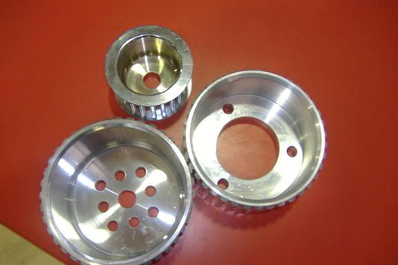

    Short water pump small block chev kit
    mmmmm very big sleeve to be made for the crank,57mm bore,the water pump holes from left to right and top to bottom straight line is 46mm....ok machining gurus what we got do farken..
    -Just Alloy Radiators-
    www.alloyradiators.com.au
