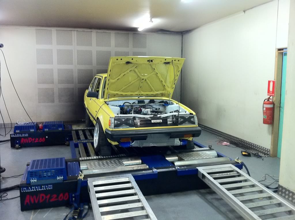

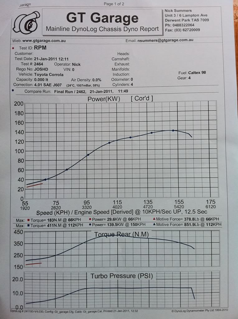

    Everything went awesome!!!!
    Only dramas were a blown fuse and we had to change the spark plugs for a different type.
    Didn't want to push any harder on it, given it is a fresh engine. Will run it like this for a while and see how it goes.

    Some respectable numbers there for a rather mild tune!
    Run her in and then lean on it!!!
